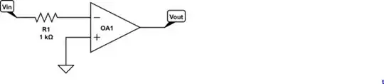

You are confusing 'inverting' with 'negative feedback'.
Open loop
schematic
Figure 1: op-amp with open-loop inverting mode.
In Figure 1 the op-amp will amplify the difference between its inputs by the open loop gain. Let's say the open loop gain is 1,000,000 and we apply +1 mV at the '-' input. Since it is higher than the '+' input the output will go to -1 mV x 1000000 = -1000 V. (Obviously on a real op-amp it will stop at the negative supply rail.)
This circuit would not make a good amplifier as the gain would not be controllable, any variation or drift in the input offsets would wreak havoc with the output and any non-linearities of the amplifier would go un-checked. It might, however, make a useable comparitor to detect if the input voltage was above or below, in this case, zero volts.

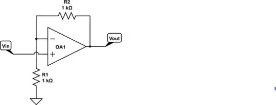

Positive feedback
Figure 3 shows the amplifier with positive feedback.
In this situation the scenario will be as follows:
  • Vin = 0. Vout = 0.
  • Vin = 1mV. Vout still at 0 so '+' input goes to +0.5 mV.
  • Vout starts to rise. The '+' input voltage starts to follow it at about half the rate (because of the voltage divider effect).
  • Vout hits the + supply rail.
This circuit is often used to make a Schmitt trigger to add some hysteresis so that turn-on and turn-off points are different.
