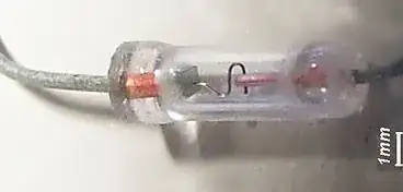

The arrow symbol is actually a simplified depiction of a point contact diode.
It happens to point in the direction of conventional current. The "way electrons move" is not important for circuit design and you should not worry or even think about it, it will lead to nothing but confusion.
