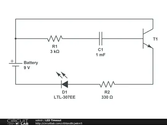

So, let's say I have this circuit:
CircuitLab Schematic 6hbnd8cjwkm5
Supposing the capacitor is fully discharged when the battery is first connected, would the LED light and then switch off after about 15 seconds? Here's my reasoning, and my (extremely ignorant and naive) expectation of how the circuit will flow:
  • When the battery is connected, current flows through R1 into C1, charging C1
  • 5RC = 5 * 3000 * 0.001 = 15, so C2 should take 15 seconds to charge up
  • During that time, current is flowing into the base of T1, allowing current to flow between the collector and emitter, thus powering the LED
  • When C1 is fully charged, current stops flowing into the base of T1, therefore current stops flowing between the collector and emitter, therefore the LED switches off.
Have I fundamentally misunderstood how capacitors work in DC circuits, and perhaps how transistors work too? If so, how could this circuit be reworked to produce the outcome I'm expecting (i.e, a circuit which uses a capacitor and a transistor to automatically switch off an LED after some period of time)?

    Your circuit is so confused I'm not even sure exactly what you don't understand. Two thoughts: 1. Connecting the cathode of the LED to the most positive supply voltage is almost never going to turn on the LED. 2. The base of the NPN BJT needs to be driven to a voltage above the emitter voltage to turn it on. – The Photon Apr 24 '17 at 16:28
  • Let's start with your first bullet point. Why do you think that turning on the battery would allow current to flow through R1 and C2, when they're connected to the battery only through a reverse-biased diode (D2) and a reverse-biased b-e junction? – The Photon Apr 24 '17 at 16:29
  • @ThePhoton I think the OP has the "little pointy things" mixed up in mind. Reverse the LED direction and substitute in a PNP. – jonk Apr 24 '17 at 16:42
  • @ThePhoton There is that point. ;) – jonk Apr 24 '17 at 16:49
  • Does current not flow from negative to positive? If it helps, perhaps you could imagine the LED was flipped around. – sdmtr Apr 24 '17 at 16:53
  • Conventional current (and you need to get used to this) follows Benjamin Franklin's first assumptions and so flows from + to -. He had a 50/50 change to get it right and... well... got it wrong (at least, when considering the usual case of electron flow.) So you are right, perhaps, if you are thinking about wires and electron flow. But we are forever now stuck with Benjamin's ideas about it a few hundred years ago. And there it is. – jonk Apr 24 '17 at 17:07
    Your circuit won't work, your explanation is therefore wrong, your commentary is fundamental to the questions you ask therefore, this cannot be answered. Voting to close as reason: unclear. – Andy aka Apr 24 '17 at 17:12
    I've just edited the circuit to follow conventional flow as best I can - again, I'm new to this, condescension isn't going to be particularly useful - and whether it works or not is entirely the point of the question: if it doesn't work, why doesn't it work? The commentary is an explanation of why I believe, wrongly or rightly, it should work, and isn't fundamental to the question of whether or not it actually would work and how it could be changed in order to work. – sdmtr Apr 24 '17 at 17:17

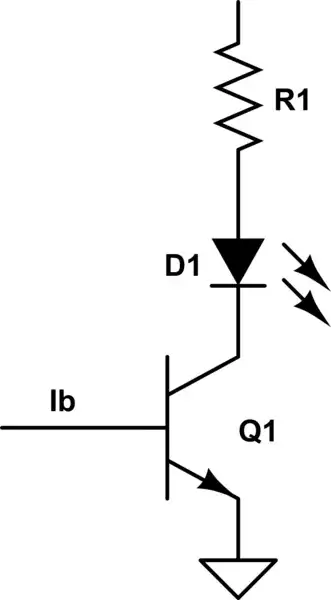

The transistor is a valve that lets current flow through it from collector to emitter (the pointy arrow) when current is injected into the base.. as shown below.
As such, as long as you feed current into the base, current will flow through the transistor and, if the voltage on the base is high enough, it will act like a kind of switch.
When turned on, current can flow from the battery through the LED lighting it up. The LED can only withstand so much current or it will burn out. The resistor is included to limit that current to the rated amount specified by the manufacturer's specifications.
schematic
So now you have a circuit that will turn on an LED.

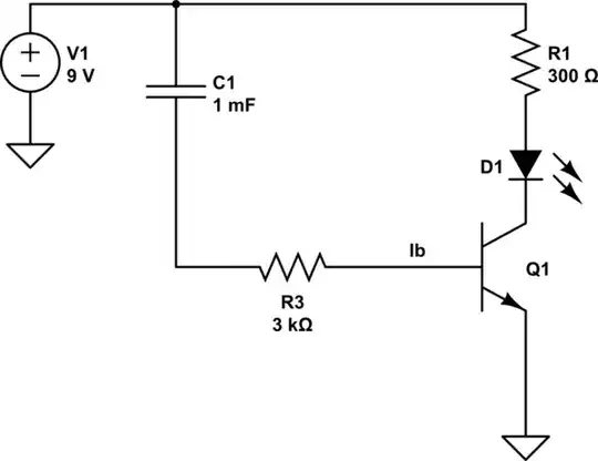

Now you need to drive that circuit with something that turns it on for a while, then turns it off. Now your idea is to do something like this.
schematic
simulate this circuit
Idea being C1 takes a while to charge up through the base limited by the resistor. Indeed with the indicated values the transistor will start to turn off around eight seconds after the power is applied.
Unfortunately a 1mF capacitor is rather physically large and expensive. The resistor choice also affects the current in the LED.

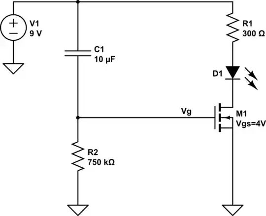

A better solution for this task is to use a different device like an N-Channel MOSFET.
schematic
A MOSFET is gated by voltage not current. This effectively decouples the timing side from the driving side. That means you can use much larger resistances, and therefor a smaller capacitor for timing without affecting the LED current.
