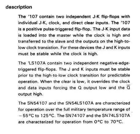

Some of the master-slave flipflops are "ones catching" types. If the input level for changing state is present at any time (before the setup time), for any length of time (greater than the minimum specified PW) before the clock edge, the flipflop will toggle. Edge triggered flipflops ignore any state that was present before the setup time. I think most master-slaves are (were?) negative pulse triggered too. I haven't used a non-positive edge triggered flipflop, counter, register, etc. in more than 50 years. It's no exaggeration to say the 7474 and its followers changed everything.
The data sheet from TI for the SN54107, SN54LS107A, SN74107, SN74LS107A DUAL J-K FLIP-FLOPS WITH CLEAR available at http://www.ti.com/lit/ds/symlink/sn74ls107a.pdf shows usage of the terms. description from data sheet
The pertinent part of it is the description section, above. The '107 is called a positive pulse triggered flip-flop, and the last sentence in the first paragraph explains why. "Inputs must be stable," means it's a ones-catching flip-flop. (More properly it would be called opposite-state-catching.) Of course the outputs change on an edge of the clock, but the data inputs can't change from the time the clock is high until that edge. "Pulse triggered" sounds better than "ones catching" so that's what is used in data sheets. "Edge triggered" means not "ones catching." The only thing that matters is the data state before the edge. The 'LS107A (edge triggered) is an improved version of the '107. In most applications it's a direct replacement. There might be places where you might want the '107 instead, I suppose. None come to mind.

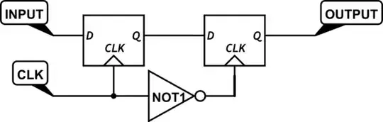

Not going to answer the question, but push you in the right direction.
A master-slave flip-flop can be made from TWO edge triggered D flip-flops.
schematic
