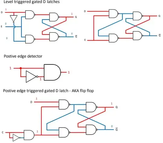

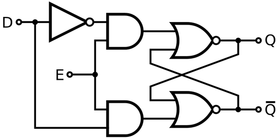

My current understanding, which I want to check, is in the diagrams below…
Side by side are what I understand are two implementations of a level triggered gated D latch.
Below these is a positive edge detector, at that brief moment when the NOT gate has not yet responded to the change input from low to high, namely the rising edge (red is 1 blue is 0).
In the last diagram, the edge detector has been fitted to a dated D latch and this is what makes it a flip-flop.
Is the last diagram really a flip flop, or is it still just a latch?

A flip flop is most typically characterized by a master-slave topology. This is two coupled (there can be logic between), opposite phase latches back to back (sometimes in industry called L1/L2).
This means a flip flop inherently consists of two memory elements: one to hold during the low cycle and one to hold during the high cycle.
A latch is just a single memory element (SR latch, D latch, JK latch). Just because you introduce a clock to gate flow of data into the memory element does not make it a flip flop, in my opinion (although it can make it act like one: i.e. more rising edge triggered). It just makes it transparent for a specific amount of time.

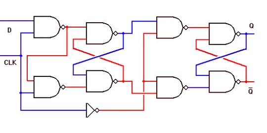

Shown below is a true flip flop create from two SR latches (notice opposite phase clocks).
true d ff

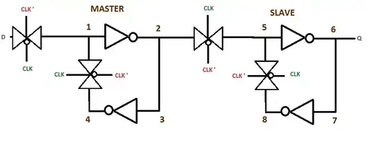

And another true flip-flop (this is the most common style in VLSI) from two D-latches (transmission gate style). Again notice the opposite phase clocks:
true flip flop tg style
If you pulse the clock to a latch quickly enough, it starts to resemble a flip flop behavior (pulse latch). This is common in high speed datapath design because of the lesser delay from D->Out and Clk->Out, in addition to the better setup time granted (hold time also must increase, small price to pay) by transparency through the duration of the pulse. Does this make it a flip flop? Not really, but it sure looks acts like one!
However, this is much harder to guarantee to work. You must check across all process corners (fast nmos, slow pmos, high wire cap, low wire r; as an example of one) and all voltages (low voltage causes problems) that the pulse from your edge detector remains wide enough to actually open the latch and allow data in.
For your specific question, as to why it is considered a pulse latch instead of a flip flop, it is because you truly only have a single level sensitive bit storage element. Even though the pulse is narrow, it does not form a lock-and-dam system which creates a flip flop.
Here is an article describing a very similar pulse latch to your inquiry. A pertinent quote: "If the pulse clock waveform triggers a latch, the latch is synchronized with the clock similarly to edge-triggered flip-flop because the rising and falling edges of the pulse clock are almost identical in terms of timing."

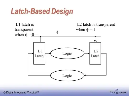

EDIT For some clarity I included a graphic of latch based design. There is a L1 latch and L2 latch with logic in between. This is a technique which can reduce delays, since a latch has lesser delay than a flip flop. The flip flop is "spread apart" and logic put in the middle. Now, you save a couple gate delays (compared to a flip flop on either end)!

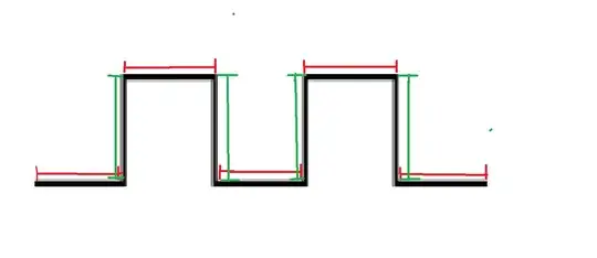

A flip flop is different than a latch. They are both bi-stable circuits, but they are two different things in fact.
The latch has an enable pin and listens to the data input/inputs only when this pin is high. When it is low, the latch freezes and memorises its state. Now even you manipulate the inputs, it won't react.
The flip flop contains a clock pin instead, which reacts only at changing pulses (level shifts). Think of a square wave. The transient time between off and on;off and on is the time in which the circuit reacts to input signals. Only then is it available to change, not when the pin is stable and fully on.
Flip flop react time
Note the green lines represent the period it listens to input and the red lines the period when it doesn't. The latch allows input only during the periods shown by the uppermost red lines.

Thanks to everyone who has answered my question. As expected, there is some disagreement. Unfortunately semantics are often more important than understanding when it comes to exams. If I need to argue with an exam board for incorrectly marking an A Level Computer Science student's exam paper (and I have done so in the past), I want to be in a strong position. I thought I'd share with you a couple of pages of the official A Level course text book.
The first diagram is an active low SR latch. The book calls it a flip-flop.
In the text, the book says "By using two flip-flops we can create a circuit called a D-Type flip-flop which uses a clock controlled circuit to control the output, delaying it by one clock pulse. The D stands for delay." This text seems to be referring to the master/slave configuration. The second diagram (figure 14.2) is labelled as a D-type flip-flop. It is actually an active high gated D latch.
Not very helpful!
I'm going to settle on "A flip flop is most typically characterized by a master-slave topology." as jbord39 has suggested, with the caveat that the term flip-flop is often used to mean an edge triggered latch, and sometimes just any sort of latch. I think this is where by book is coming from, albeit not getting there convincingly.
