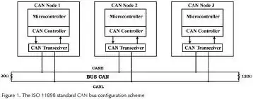

This is a very good question. As a general rule, CAN requires a transceiver for every node:

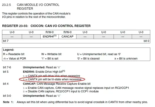

But here's something even more interesting: The PIC actually has hardware support for transceiverless CAN!
CIOCON Register
You can configure the CAN TX pin so that is behaves in exactly the same way as the transceiver. This means you can wire up the CAN bus without the diodes. You'll still need the resistor though.
Simpler CAN

    If I understand correctly, it looks like the PIC's "pin will be tri-state when recessive" setting is equivalent to an open-drain configuration. This might work on other microcontrollers (like an STM32) if the CAN TX pin is configured as open-drain rather than push-pull. Like the PIC, no diodes required. – JimFred Jun 29 '15 at 20:15
    Note that this will work if all the devices on the bus use the same configuration, and use a single-wire CAN bus. If you want to interface with anything else that is actually "real" ISO CAN and uses a two-wire bus, this mode won't work. – Jon Watte Jul 22 '17 at 05:40

Yes, you need a tranceiver. The CAN pins on the micro are receive and transmit. The CAN bus itself uses a twisted-pair with differential signalling on two wires called HIGH and LOW.
One of the transceiver's jobs is to take the logic level you present on the TX pin an turn it into CAN bus signals:
  • a logic '1' is represented by not driving the bus, so the HIGH and LOW lines "float" to 2.5V - called a "recessive bit" in CAN terminology.
  • a logic '0' is represented by driving the HIGH line high and the LOW line low - called a "dominant bit" as it will override any recessive bits being transmitted.
The other is to take what is on the bus, and turn it back into a logic-level to send back from the RX pin to your micro.
