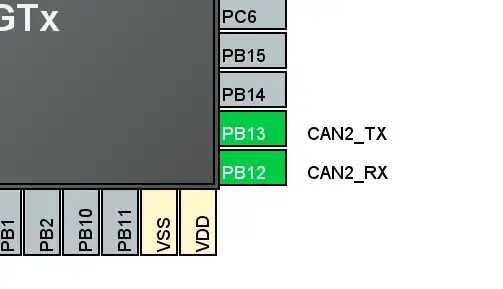

For example in STM32 MCUs, the CAN pins are CAN RX and CAN TX. Therefore to transform it to CAN H and CAN L, we need to use external CAN tranceiver. What's the purpose of it? Wouldn't it be easier to connect CAN H and CAN L directly to MCU, without using CAN tranceiver at all?
