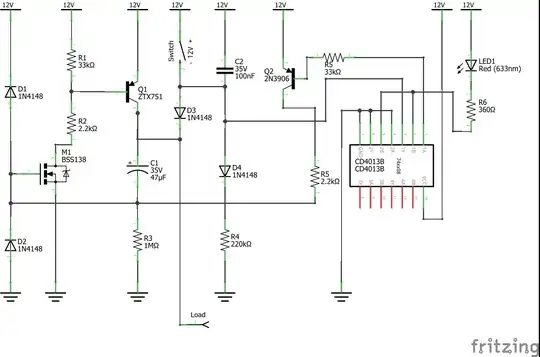

Good news, I have hit it with a stick a lot, made some guesses, then some changes and have managed to get a result...
I couldn’t get the existing flipflop to work without the timer so I looked at some CD4013 on-off circuits online (and built one to make sure my components weren’t faulty). The result being I combined the flipflop I built with the circuit provided by Jonk. The timer circuit is the same, but the flipflop C2, D4 and R4 area is now a bit different and I have grounded pins 4 and 6 on the CD4013. LED 1 and R6 don’t have an impact on the operation; they are there so I can see when the flipflop switches.
When the circuit is off I am seeing the base of Q2 sitting at 11.27V (collector at 0.01V) and when the button is pushed the base drops to 10.95V (collector rises to 11.65V). The power supply is stable at 11.8V. In its off state (standby) the circuit appears to be consuming about 21mA including LED1 which is on when the circuit is in standby. When active it consumes 87mA which includes the relay and 2 LEDs indicating the relay has switched to the NO pins.
I am interested to hear if this circuit can be improved and/or if the Volts and mA I have recorded are good or could be better...

Edit; I have found the circuit switches on and switches the relay when the power is connected. The flipflop and timer delay work correctly after that. Is there a way to prevent the self starting with power on/the main power supply is connected?

I believe I now have it working well. Irrespective of button press speed-duration there isn’t any bounce, the off timer duration is (now) consistent, the collector voltage on Q2 is now stable, the Q2 switching base voltage is now around 0.8V (I was seeing less than 0.5V) and the relay is off when powering up the circuit. With the exception of the inclusion of C2 and D4 and a change in the values of R4 (100R) and C3 (100nF) it is basically the same as the one Jonk posted.

  • Part 1: the parts arrived and are assembled. Good news first, the momentary push starts the circuit, the relay closes and changing C1-R3 alters the delayed shutdown time. But then there is a problem, the circuit automatically/immediately begins a timed shutdown without a second button push. I need the circuit to stay on until the button is pushed a second time which would release the latching side of the circuit but the 240V supply continues running (via the timer) for a set time (approximately 1.5 minutes) and then the relay releases thereby cutting the 240V supply to the transformer. – Barnys May 23 '17 at 13:57
  • Part 2: Have I assembled it incorrectly or is the circuit working correctly and it was my initial description that caused some confusion? – Barnys May 23 '17 at 13:57
  • @Barnys I would be worried about the power on reset state of the flip flop. Can you determine that? Another possibility might be the exact values of $C_2$ and $R_6$. Disconnect $D_3$ entirely (leaving the timer completely out of the loop) and disconnect $R_5$ and then focus on the flip flop side of things. Does it work? It should toggle to the next state each time you press the button. – jonk May 23 '17 at 16:18
  • @Barnys Also, you may need to re-check all your pin assignments. I didn't specify pin numbers on my diagram. Did you correctly pick out right pins for the right functions from a datasheet? – jonk May 23 '17 at 16:24
  • I have compared the circuit I posted above (as an answer) with the one you gave me. Apart from grounding pins 4 and 6 the only real difference is the position of C2. The circuit works when C2 is connected between +12V and the D4-R6 junction, it doesn’t matter what type of capacitor is there and within reason, the capacitor size doesn’t make a lot of difference. A larger uF appears to increase the required latch/release button press duration. I would appreciate any thoughts you might have about the reliability-stability of the circuit I have posted. – Barnys May 26 '17 at 07:39
  • @Barnys That is different in the sense that the capacitor is no longer on the other side of the diode I had placed in order to isolate the two circuits. And the diode now isolates that capacitor away from the trigger input. Which means it isn't doing anything useful. If things are working without it, I'd just remove it, since it doesn't make any sense where you have it. – jonk May 26 '17 at 17:09
  • thanks for the reply and your help so far. The C4-D2 positioning is (to me) a bit confusing. The only way I can get it to work is to have C2 connected directly to the +12V. The circuit works best if I move D4 between C2 and the switch-D3 junction (a little different to the circuit I posted). Placing D3 between C2 and the switch-D3 junction appears to help with switch bounce, i.e. irrespective of button push frequency and/or duration, the circuit switches more reliably in that configuration. – Barnys May 31 '17 at 10:08
  • Part 2. The circuit is running about 95% reliably in that occasionally the flipflop doesn’t change its state with each button press. I have been looking at 4013 debounce circuits but haven’t improved on what I have (I have seen a lot that are the same as the D4, C2 and R6 combo you suggested). – Barnys May 31 '17 at 10:09
  • @Barnys One thing I didn't add to the circuit was an RC reset. I do think this is more about debouncing because you say it doesn't always change its state. But the reset circuit is easy to add. A series cap+resistor from Vcc to ground, with the midpoint tied to CLR of the FF. A 0.47uF for the cap and a 10k for the resistor (to ground) would be good enough, I think. The rest is really about debouncing that switch. When you see that the FF hasn't changed, I think this is because an even number of pulses are seen. Bigger cap where I had it, or try a different switch? – jonk May 31 '17 at 16:01
