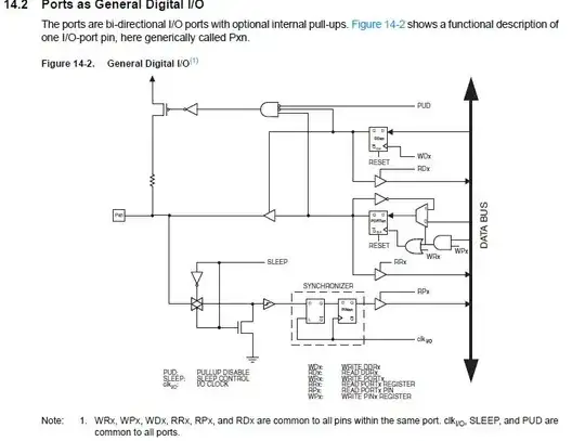

This is the IO port of ATMEGA328p according to 76 page of datasheet.
ATMEGA328p GPIO
As I know, Pull up is the most suitable system because lots of voltage spikes are logic 1.So, if we can give logic 1 normally, we can avoid unwanted triggering causes by spikes.
This thread has some explanation. But,it can't satisfy me.because ATMEGA328p port is bi-directional.
Explain what is the most suitable way(pull up/pull down) when we use a button input to the port with help of diagram above.

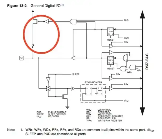

The ATmega328p I/O block only provides pull-up functionality. There is no internal pull-down. I've circled the relevant bit of the circuit in the diagram below -- notice that there is no "mirror" of this circuit to pull the pin to ground.
(It is, of course, still possible to drive the pin to a hard low. However, this is not suitable for use as a pull-down; the pin will always read as low if it is being driven low, and the I/O block may be damaged if it is forced to sink more than its limit of 40 mA from a pushbutton.)
If you disable the internal pull-up resistor, you can certainly hook up an external pull-down resistor. There is no significant advantage to doing so, though, especially for a low-speed I/O like a pushbutton.
ATmega328p I/O block, with pull-up circuit circled
Your premise that a pull-up is somehow less susceptible to noise has no grounding in fact.
With CMOS devices it really does not make much difference. The current required is pretty much the same for both a pull-down and a pull-up. TTL on the other hand requires a pull-down to sink a considerable amount of current. The latter is probably the main reason for the prevalence of pull-ups.
If the line is to be driven from another IO pin though, you should chose whichever side produces least load on the driving pin.
Generally the choice of which to use is more governed by the ensuing logic rather than the circuit requirement.
