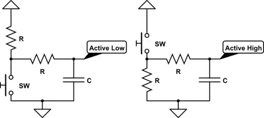

If the signal doesn't already have a specification, use whichever one makes the most sense to you. It is your choice to make an input active-high or active-low.
If it's buttons, make sure to use a debounce circuit (or do it in software).
schematic

    +1 for the only side-by-side comparison of active-high vs. active-low I've seen. Nice, clarifies things. – TomServo Dec 01 '18 at 11:10
