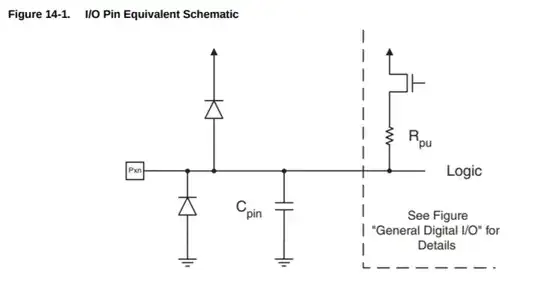

Here is a diagram of the equivalent circuit for your Atmega328p:
Note the diodes from ground to VCC.

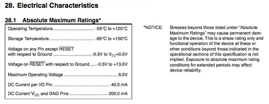

From the datasheet:
ATmega328p datasheet: "Electrical Characteristics: Absolute Maximum Ratings"
The maximum voltage on any pin other than _RESET is specified as "Vcc + 0.5V". If the chip is unpowered, Vcc is 0, so no -- you cannot safely apply any voltage above 0.5V.

At the input of most pins on a device such as the AVR ATmega328 there are diodes to protect the chip from electrostatic discharge (ESD). These diodes connect to the supply rail of the device.
If you drive a logic signal into a pin when the device is unpowered it will attempt to power via the diode. This may not cause damage, but often it will affect the power-on-reset circuitry, so the device will not power up correctly when power is available. It is often a cause of unexpected power consumption in battery powered circuits.
You need to put in a multiplexer to select which MCU drives your motor driver or arrange that both MCUs are powered, but the one that is not intended to operate the motor keeps its I/O ports in a high-impedance state (e.g. as an input).
Typical MCU I/O port
