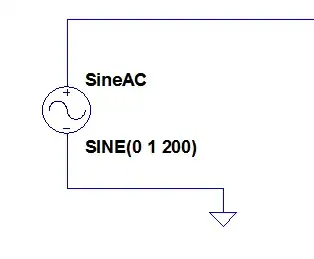

Below the sinewave generator SineAC outputs a fixed 1Vpp 200Hz sine wave in LTspice:
This output goes to another circuit and I can see the output of the entire system in time domain at a particular set frequency, in this case 200Hz.
But is it possible to vary/sweep the frequency of SineAC signal generator above along time(not AC analysis)? The reason is, I would like to see the output of the system in time domain when the frequency changes.

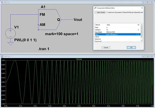

The suggestion by a-concerned-citizen is actually pretty easy to set up. First off, just go to LTspice's help and do a search for modulate and then select the "Special Functions" offering. There is a short discussion there, plus a reference to an example circuit that can be loaded and examined.
Here's a capture of LTspice where I added one of these and set it up to go from \$1\:\textrm{Hz}\$ to \$100\:\textrm{Hz}\$:
I took the trouble to also show the LTspice dialog box where I inserted the mark and space values, as well.

    A better solution is the modulate, or modulate2. Behavioural sources will lose precision if there are large dynamic ranges to be calculated, be they amplitude or frequency, but the modulate is an A-device and it performs better. – a concerned citizen Mar 12 '17 at 07:12
  • @aconcernedcitizen Thanks. I haven't ever needed a chirp in LTspice before and just came up with that on the spot. I will take a look at what you mentioned. – jonk Mar 12 '17 at 08:07
  • sounds interesting, if any of you can implement an example here with "modulate", it would be great source. – user16307 Mar 12 '17 at 21:01
    @user16307 Done. Just added it. – jonk Mar 12 '17 at 23:13
  • @jonk thank you very much, this is great to visualize and fast. – user16307 Mar 13 '17 at 16:37
    @jonk This may be years too late, but it would help if the formula for the modulate was shown: V(AM) * ( space + V(FM) * (mark - space) ). Can be easily compared with a simple voltage source with sin 0 {am} {space+freq*(mark-space)}, with appropriate parameters. – a concerned citizen Aug 15 '20 at 18:50
