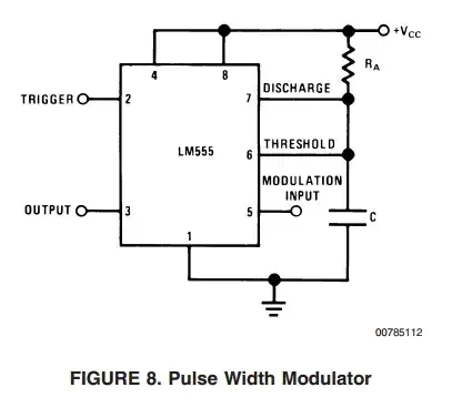

If you need a PWM control, I would suggest looking at the datasheet, where you can find a good PWM modulator:

  • The PWM reference design requires a failing edge trigger signal - what's the simplest way to generate that? – Andrew Mar 23 '12 at 13:54
  • @Andrew Right, you need a clock for that; probably the pulse positioin modulator could work for you... – clabacchio Mar 23 '12 at 15:29
  • @Andrew: You could use a 556 (dual-555) chip, and use one of the timers in the traditional astable configuration to clock the other in the PWM configuration. – Kaelin Colclasure Mar 23 '12 at 19:54
    @KaelinColclasure Yeah but I think it's getting too complicated for driving a simple fan; probably the third scheme he showed is easier to set up. – clabacchio Mar 23 '12 at 20:30

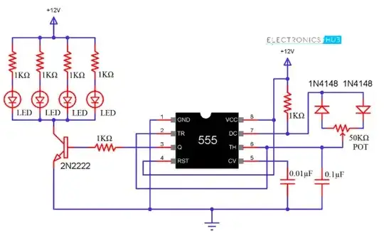

I believe the best solution (which I am using and grabbed from https://www.electronicshub.org/pwm-led-dimmer-using-ne555/) is to use the first circuit (in the OP) but use diodes on the potentiometer in order to allow the duty cycle to vary from near 0% to near 100%.
The load shown is LEDs (with current-limiting resistors), IOW, a dimmer for the LEDs.
I am using a Darlington BJT device (http://www.mouser.com/ds/2/149/KSD560-63636.pdf) because I'm going to want to control quite large loads (several amps) so the much higher DC current gain of the Darlington configuration is good.
Looking at the datasheet for the LM555, note that the high-level output is guaranteed to only be 3v or so (for Vdd=5v), which probably precludes using a power MOSFET (most of which don't guarantee Vgs-threshold to be below 3v). But the DC current gain of the Darlington is so high that it almost looks like a MOSFET, except drops a little more voltage (from collector to emitter, versus from drain to source).
I'm using this as a dimmer also. A big issue I ran across is that the LED bulbs I'm using have a capacitor in them. If the PWM frequency is too high, that waveform is filtered out and you can't dim very low. But if you lower the PWM frequency too much (by increasing the size of the capacitor on pin 6 or the resistance of the potentiometer) then you'll get flickering; so it's a compromise.
