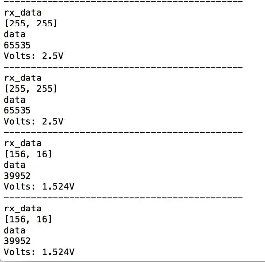

My values were consistently wrong. I think my code works correctly. I have tried both using pigpio and spidev and both give the same wrong results.

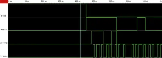

I used piscope on two different raspberry pis to make sure the problem wasn't from my pins. The results are shown below. This is different from what I would expect from the datasheet as the pulses aren't even. but there are 16 pulses nonetheless.

- Does anyone have any idea why my waveforms are coming out like that/how to fix it
- Why do I get random values?
- Would bitbanging/software SPI solve the issue?
