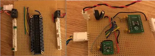

I tried to use the guides for connecting the MCP3008 to connect the IC to the raspberry pi. My connections were SCLK->SCK (Purple), MISO->SDO(Green), MOSI->SDI(Yellow), CE0->CS/CONV(Blue). enter image description here I used spidev for the SPI communication, because it looked like the most popular one (I didnt quite understand WiringPi). I tried to get a differential input between channel 0 and 1

  1. Have I connected the ADC to the raspberry Pi correctly.
  2. Am I sending and receiving the bits correctly?
  3. How do I use Wiring Pi to communicate to the ADC or how do I communicate with ADCs that aren't MCP3008 and similar.
  4. Lastly, while checking he SCLK signal on an oscilloscope, it showed no pulses. Any idea why?

  • if possible add wiring circuit diagram from pi to LTC1867 – Raj Feb 08 '17 at 17:28
  • @brhans I thought the spixfer2() returned the next set of data. So when I do spi.xfer2([0,0]) and it returns lets say [192, 224]. Are you saying I discard the 1 set of data (i.e 192)? If so, since I am expecting 16 bits back how do I get the remaining 8 bits because a 3rd set of data is never returned. Also the data sheet makes it look like the SDO returns only the bits I need. A bit confused – Baba Feb 08 '17 at 18:49
  • @Raj just added them – Baba Feb 08 '17 at 18:50

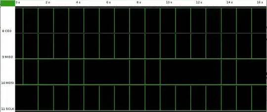

If any one has this problem, my suggestion would be to use an oscilloscope (or install piscope) to see what the MISO, SCLK, CE0,and MOSI are doing. Mine are behaving strangelyenter image description here
My next task would be to find out why. I'm sure that would be the root of the problem.
