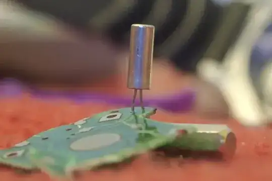

The first question is: What is the frequency of the clock I obtained from the watch? And will it work well with the microcontroller? What caps should I use along with it? Is there anyway to test to see if it still works?
The Crystal doesn't have any text printed on it, it's 3mm wide and 8mm high without the leads.

First go here and get the datasheet for the microcontroller. Read the table of contents. It has pretty much all information you need. If you take a look at the oscillator section (14.2), you'll see wha you can use with this microcontroller. Basically (if we assume that the watch crystal is 32.768 kHz, but more on that later) you'll need to use capacitors in the 15 pF to 30 pF range for the oscillator to work and use the LP mode. Also from the same page:
Note: Higher capacitance increases the stability of the oscillator, but also increases the start-up time. These values are for design guidance only. A series resistor (RS) may be required in HS mode, as well as XT mode, to avoid overdriving crystals with low drive level specification. Since each crystal has its own characteristics, the user should consult the crystal manufac- turer for appropriate values of external components.
This brings me to my next topic. I'd recommend against using the salvaged crystal if at all possible. While the crystal may be operational, you don't have its specifications and the standard can isn't going to be easy to identify (and the assumption that the crystal is 32.768 kHz may even be wrong!). Instead I'd recommend that you get a crystal from a reputable source and to read the crystal's datasheet. It will probably have more information on the needed capacitors, crystal's accuracy and so on.

The watch crystal will be 32.768kHz, so devide by 2^15 for 1Hz
