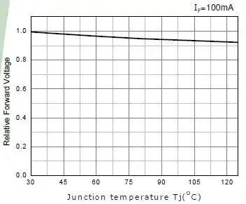

  • OSCILLATIONS? : As shown in the typical graph below, the effect of increasing temperature is to slightly decrease the forward voltage for a given current, As Vf is common to all LEDs this will instead have the effect of slightly lowering the overall group VF and of increasing the share that this LED takes.
    As an LEDs VF/current curve is not linear this will not "run away" indefinitely but will assume a new higher current value. Other LEDS may then have very slightly less current so cool somewhat so draw less current so decrease group Vf so decrease net current so ... . This is the "oscillation that is referred to in the post you mentioned by Rocket Surgeon and it is a real effect but it will essentially always be such a small effect that you will not notice formal oscillation - just a very small continual shift of overall operating point.
