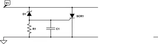

You may consider a thyristor crowbar circuit.
schematic
If the voltage rises enough to cause the zener to breakdown the thyristor is triggered and shorts out the supply. If the fuse doesn't blow (or doesn't exist) the thyristor will remain on until the current is switched off. C1 reduces susceptibility to noise.
The term 'crowbar' is a railway term from third-rail electrification systems. In the event of an emergency the lineman could trip out the electrical supply by throwing his crowbar between the live and one of the running rails on the track.
This circuit is not very precise due to variability in thyristor turn on voltages. See Axotron crowbar circuits for more ideas and improvements.
