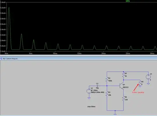

I'm trying to create a common emitter amplifier to power a medium sized 8 ohm speaker as a learning experience using one NPN transistor specifically the PN2222A.
Here's the design schematic in LTspice. enter image description here
The arrow pointing to the 8 ohm resistor is the speaker that I'm using. I put it in the simulator so I can see how much current would be going through it. I run the simulation producing a 400hz sine wave. The results are a clipped sine wave current going from only 1.6mA to 3.2mA. Which is much smaller than what the input of 200mv could produce on its own.

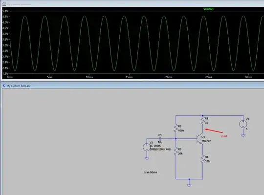

enter image description here I removed the 8 ohm resistor and ground so I can check to see the voltage of Vout.
The results are normal. The gain is about 7x of the 200mv input.
I then tested this using my breadboard hoping it would yield different results. It did not and what resulted was a quiet speaker that produced a distorted sound. I could push my speaker much louder by just connecting the 200mv input directly into the 8 ohm speaker.
Why is it when I add an 8ohm speaker to Vout which has a normal voltage level gain of 7x of the input, that my current is completely distorted and only pushes 3.2mA through the speaker? Shouldn't plugging my 8ohm speaker into Vout give me something around 300mA?
How do I fix this problem? Please be as detailed and informative as you can. I am new to circuits and circuit design. Thanks.
    R3 should be at least equal to R2. The emitter resistor is several factors to low. A 2N2222 will never drive an 8 ohm load. You need to AC-couple to the load. – user207421 Oct 08 '16 at 02:06
    I suggest that you invest in The Art of Electronics. – pipe Oct 08 '16 at 02:31
    Max, take a look at your speaker and what it's hooked up to. There are lots of things wrong. (1) The BJT can pull down hard on the speaker, but there's nothing to pull up on it -- R1 won't hack it. (2) There is a constant DC current running through the speaker. And there's more. What's the gain you want? What's the voltage supply you WANT to use? Are you willing to use a cheap IC, instead? Or do you actually want to be able to design these things for speaker output? – jonk Oct 08 '16 at 02:34
  • @jonk Well I just want to make it work. A gain of 10 would be nice. The voltage supply I'm using is 5V. And I would rather not use an IC, it would be nice to be able to connect it directly to a speaker. Overall I just wanted to see if I could make a generic amplifier using a simple transistor. – Max Hastings Oct 08 '16 at 02:50
  • Max, one transistor probably won't cut it. You can get voltage gain of 10. But it is going to be very difficult to get an increase in current compliance, too. The speaker represents a very small impedance and it also requires a matching drive impedance to transfer power with any modest efficiency. Are you willing to consider using more than one BJT? Or is this some kind of minimalist idea? – jonk Oct 08 '16 at 03:03
  • @jonk Well I would like to use the least amount of components as possible. I don't mind if the gain is lower than 10 if that lets me have less components. This is just a personal learning experience and it would be nice to make a very simplistic amplifier. I may be able to add another BJT depending on how many more components that would need. – Max Hastings Oct 08 '16 at 03:11
    Since the gain is -R5/R4 it is pretty obvious that 8/330 is much less than 1. – Tony Stewart EE75 Oct 08 '16 at 05:15
To start out, you need something that can both push and pull on your speaker. This "something" is called the output stage. (Which implies that there is more than one stage, by the way.) Broadly speaking, for good performance this usually means two active devices, not one.
It can even mean four of them, if you set them up in an H-bridge; aka, bridge-tied load (BTL.) You can look at the TDA8551 for an example of a \$1\:\textrm{W}\$ BTL style amplifier. A main reason to consider a BTL is that you can get more power from a single power supply rail. In your case, with \$5\:\textrm{V}\$, this might be a useful advantage. But doing it from scratch and not using an IC comes with complexity. So it's off the table.
In all these output stage cases, the voltage gain is usually taken to be about one. The main purpose of the output stage is to match up impedances and deliver power. Power is both voltage and current. But the usual approach here is to get the voltage taken care of first, before it arrives at the output stage, and then just focus on improving the current compliance at the output stage. So a voltage gain of about one is fine.
Your amplifier topology is a standard (sub-standard and more bookish teaching form, really) one when voltage gain is desired. It won't drive a speaker well. It's not designed to deliver power into an \$8\:\Omega\$ speaker. And it pretty much won't. It comports more with an earlier stage. Let's hold short of using it, for now.
(It might be possible to design a one-BJT amplifier to work with your speaker, but I'm almost certain you'd also need a transformer unless you wanted to run things class-A, with a substantial DC current, limited speaker travel and probably some rather weird distortions from mechanical asymmetries. I'm not going to approach either of these here.)

  • I appreciate the detailed information. However, I don't think I have enough parts to build something of that scale. Instead I started to tinker around and added an npn transistor to my Vout. Then had the emitter go into the positive end of my speaker, and the collector be hooked into the 5V power. I ran the simulation on LTspice and it showed about a 100ma current through the 8 ohm speaker. I tested it on my breadboard and it seems to work, it's much louder than before. It only seems to have a bit of low frequency distortion and some electrical noise, but for the most part it sounds decent. – Max Hastings Oct 09 '16 at 05:33
  • @MaxHastings As an emitter follower, class-A. Yeah. That will definitely react like I mentioned it would in the text. If that's okay, then it is. Best wishes! – jonk Oct 09 '16 at 06:20
  • You don't have R3 connected correctly. – user207421 Oct 09 '16 at 09:29
  • @EJP I think I do have it correctly placed and sized. But I make mistakes. Tell me about the problem you see. – jonk Oct 09 '16 at 09:32
  • R3 is cool as far as I can tell - it allows the drive level to Q1 to be higher than 5V and thus turns on Q1 better. It's called bootstrapping @EJP - good circuit +1 – Andy aka Oct 21 '16 at 11:51
Think about maximum power transfer equation: Your circuit has an output impedance of 3k and you're trying to drive an 8 Ohm load. Impossible to achieve an healthy output. You need a power amp.
