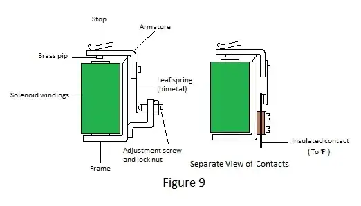

Remnant magnetism is a concern to relay designers.
Figure 1. The addition of a brass "pip" on the armature prevents magnetic latching. Source: David McAudrey.
When a small electric current passes through the energising coil, the armature is magnetically attracted to the end of the rod against the bias force of the spring and, if the Ampere-turns are sufficient, it will rock to close the gap in the magnetic circuit. In practice a small brass pip on the underside of the armature prevents the gap from becoming fully closed; otherwise it would tend to stick in the energised position when the energising current is switched off.
A similar approach is what is required in your application but, as others have said, a thin layer of non-ferrous material may suffice.
