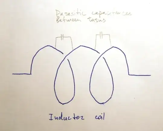

What Pentium100 said. I can only add an illustration. Please excuse my hand drawing skills.

Capacitors have two conductive plates separate by an insulator. The turns of wire in a coil can also create a capacitor because between each turn of wire there are two conductors separated by an insulator, which can be air, enamel, ceramic, etc. When the right frequency is applied to the inductor, the inter-turn capacitance can create a resonant circuit. This inter-turn capacitance only happens with AC and not DC because inductors are a short with DC.
