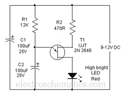

You'd probably want a astable multivibrator. Here's one easily constructed with discrete components:
By jjbeard - Own drawings, made in Inkscape 0.43, Public Domain, https://commons.wikimedia.org/w/index.php?curid=873818

Here you go. But a 555 would be easier, require a smaller capacitor and it might be easier to explain how it works.

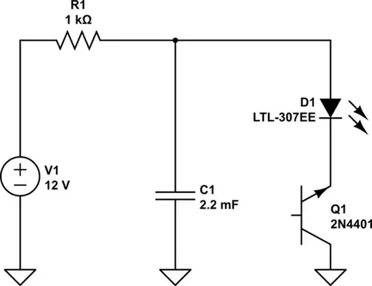

2Wow that even beats my old favorite LM3909 for simplicity - although the LM3909 could run off 1.5V :) – brhans Aug 29 '16 at 16:56
1How does this work? I would maybe expect the 2N4401 to go into zender mode, but not into blinking? – Wouter van Ooijen Aug 30 '16 at 05:50
3@WoutervanOoijen In this parlour trick, the BE junction avalanches, so there is a region of negative resistance that makes this (usually) work as a relaxation oscillator with the component values shown. The negative R isn't all that great (maybe -100$\Omega$) so it would be swamped by series resistance in the usual zener mode circuit. It's supposed to degrade the transistor $\beta$ long-term, but I tested it with continuous 20mA and didn't see much bad effect. YMMV, but just to be safe I wouldn't use the transistor for anything else afterward. – Spehro Pefhany Aug 30 '16 at 09:32

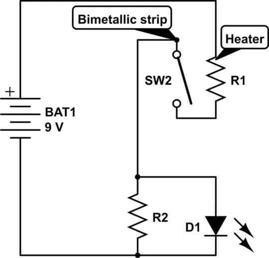

It is possible to create a light flasher using just a heating element and a bimetallic strip. It's likely to be horribly inefficient, but it can be made to work.
And there's not even a transistor needed.
There's an example here Evil Mad Scientist using a blinking incandescent lamp, of the sort sometimes used in Christmas decorations.
