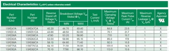

I have a 48v battery powered system is charged by normal lead acid charger that might reach up to 14.5v and maybe 15v per battery ( total 58v to 60v ). The circuit contains components rated for 75v and 100v . As everyone else i get confused by the various ratings and how they are related to my needs:
1. reverse standoff voltage
2. break down voltage
3. maximum clamping voltage
I would like to know which TVS fits 48v circuit (voltage rating wise):
from littel fuse 1.5KE series I cut this image : enter image description here
my first impression is to use the 1.5KE68A because the reverse stand-off voltage is approximately equal to maximum Vcc, but the maximum clamping voltage is way above the 75v rating of the regulator. Even the 1.5ke56 has clamping voltage of 77v.
Question:Which TVS should i choose ? or is this a limitation of TVS and i should consider other type of clamping ?

Simply put, the part you want does not exist. Standoff voltage should be equal or higher than the max normal operating voltage, in your case 60V. So the 64V part is the way to go. On the other hand, max breakdown voltage on that part is 79V which may or may not keep the 75V regulator alive. You would probably get away with using that 58V part but the min breakdown voltage of 64.6V is awfully close to the actual operating voltage.
Finally, the clamping voltage applies to sudden transients, think lightning and other spikes in the power network. Spec says that if you have transient current of 14.8A, the part is guaranteed to keep voltage below 103 volts.

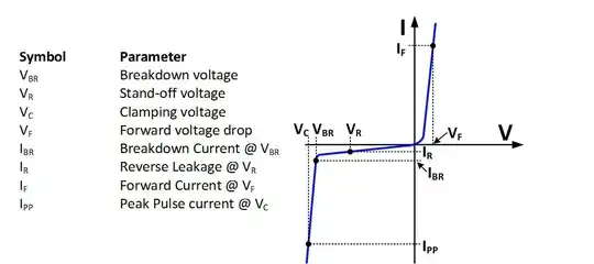

This picture should help: -
Stand-off voltage relates to the maximum normal working voltage your system might see and, according to the detail in the question, this will be as high as 60V. However, in your specific situation I would look at the break-down voltage specification.
In the Littel Fuse table it tells you that Vbr is measured at 1 mA and this is a really insignificant current for a large battery so, maybe you could start to consider the 1.5KE56. However, the maximum clamping voltage could be 77 V so this puts in jeopardy components only rated at 75 volts.
The next device down has a clamping voltage of 70.1 volts and this would be suitable for use as a protection device but how much current will it take when 60 V is applied across it?
You cannot make a decision on the information given. Maybe 10 mA leakage current (Ibr) is acceptable and maybe the 1.5KE51 could be chosen through manual select-on-test procedures.
I would consider trying to get components rated at only 75 volts up to a rating of 100 volts.
