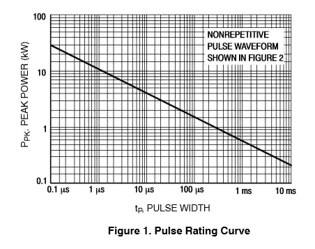

Calculating the peak junction temperature for a short pulse is difficult. The 226°C/W is for steady state or dissipation that is much longer than the thermal time constant of the device.
1SMB5.0AT3 Pulse Rating Curve
The pulse rating curve (Figure 1, above) in the data sheet shows how much power the device can dissipate for a single pulse event. It's probably safe to assume that the pulses along the line cause the junction to heat to somewhere between 120°C and the maximum of 150°C. From that you might be able to estimate a thermal time constant and come up with a general formula for junction temperature for a given pulse.
You can see how that would work in this WikiPedia article: Thermal time constant.

  • Thanks for the reply, I found more detailed datasheet here http://www.vishay.com/docs/88390/smaj50a.pdf , they are showing impulse impedance it in figure 4. Can you help me understand, is this for peak pulse rating and how to exploit this graph. – Adi May 04 '14 at 18:13
  • @Adi Sure, find your pulse width on the x-axis. Say it's 1 ms. Read the thermal impedance on the y axis, say it's 2 degrees C per watt. Now if your pulse is 10 watts your junction will rise 20 degrees over ambient. – John D May 04 '14 at 23:56
  • I am getting something wrong. from figure 5 , 1000microseconds corresponds to .8C/W and from figure 1, I get 0.3KW . the result is 240C. – Adi May 05 '14 at 07:39
  • The issue is that figure 1 defines a very specific type of pulse (see Fig. 3), which hits the peak power for a short defined time. Though they don't specify the pulse shape on the transient thermal impedance curve I believe it is specified for a pulse that stays at the peak power for the entire duration, a rectangular power pulse. Therefore for that type of pulse, at 1ms you can only dissipate something like 80W abs max. For the other waveform that only touches the peak power for a short time you can hit a peak of 300W. – John D May 05 '14 at 13:30
  • Thanks for clarification, but I am getting 240C Tj above ambient...... :-( – Adi May 05 '14 at 14:18
  • Time for a bigger TVS part? – John D May 05 '14 at 17:16
  • But, this calculation is in datasheet graph itself. – Adi May 05 '14 at 17:44
