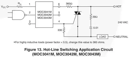

After a long search I came across this circuit:

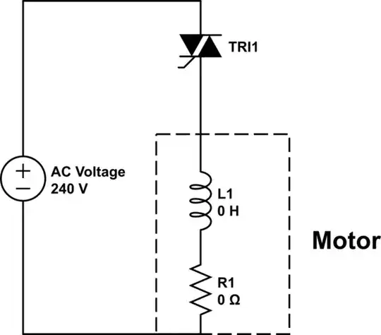

First off, I tried to hook the TRIAC (2N6073AB) to 240 VAC. It scattered into two pieces after about 5 sec. It says it's meant for 400 VAC, so I'm a bit confused. I didn't have a heat sink attached though, but still. Can someone explain this behaviour?
This is how I connected the TRAIC for testing purposes:
schematic
For the circuit above, I bought 1/4 watt resistors. I cannot understand how they can handle 240 VAC, seems really strange to me. Maybe they can't. Like the capacitor in series with the 39 ohm resistor. How is that even possible?
What role does the 330 ohm resistor play, why is this one needed? It also says "for highly inductive loads, change this value to 360 ohms." What value? Is it the 39 ohm resistor? Why change it, is it because of the high start current for motors?
For the 0.01 microfarad capacitor, where does this value come from? From what I've softly read, the snubber circuit is to prevent the phase shift between voltage and current caused by the motor, right? Will these capacitors do: blue ceramic disc capacitors 1KV 1000V 103PF 0.01uF?
I've been reading some PDFs about thyristors (including TRIACs,) and it said:
"The output of most microcomputer input/output (I/O) ports is a TTL signal capable of driving several TTL gates. This is insufficient to drive a zero-crossing TRIAC driver."
I guess that's not the case with Arduino Nano since it uses a PWM signal. Do I still need the NAND-gate? If someone would like to explain why the zero-crossing TRIAC driver doesn't accept certain signals, I would be grateful.

  1. So first off; I've tried to hook the TRIAC (2N6073AB) to 240 VAC, it scattered into two pieces after about 5 sec.
Without a schematic of your wiring we can't say. It sounds as though you mis-wired it or switched it on to a dead-short between mains and neutral. There's a schematic button on the editor toolbar if you wish to update your question.

  1. What role does the 330 ohm resistor play, why is this one needed? And it also says "for highly inductive loads, change this value to 360 ohms", what value? Is it the 39 ohm resistor? And why change it, is because of the high start current for motors?
There are three resistors in your circuit.
  1. For the 0.01 microFarrad capacitor, where does this value come from? And from what I've softly read, the snubber circuit is to prevent the phase shift between voltage and current caused by the motor, right? Will these capacitors do: Blue Ceramic Disc Capacitors 1KV 1000V 103PF 0.01uF?
Covered above. I don't know what the 103PF means. The Littlefuse article should give you enough detail on this.
  1. "The output of most microcomputer input/output (I/O) ports is a TTL signal capable of driving several TTL gates. This is insufficient to drive a zero-crossing TRIAC driver."
You don't quote a source for this but it looks a bit out of date. Most of the micros can now switch 20 mA and this is plenty for an opto-isolator LED.
  1. I guess that's not the case with Arduino Nano since it uses PWM signal? Or do I still need the NAND-gate? And if someone would like to explain why the zero-crossing TRIAC driver doesn't accept certain signals, I would be grateful.
PWM isn't used with triac control circuits. This is explained in my answer to Activating SSR for an AC motor via PWM input.

    "It sounds as though you mis-wired it or switched it on to a dead-short between mains and neutral."
    • Well, I was afraid of damaging the MOC3041 and the microcontroller, so I wanted to test the TRIAC first. But here is how I connected it: http://i.stack.imgur.com/UWvPV.png
    – MrMongoloid Jul 31 '16 at 19:58
  • I also want to add that I am truely grateful for all your links as well, I'm most certanly gonna read them. As I found it rather difficult to find good reading materials myself. – MrMongoloid Jul 31 '16 at 20:03
  • The connection looks OK but there's no trigger circuit shown. By the way, there's a schematic button on the editor toolbar and it embeds editable schematics into your post. – Transistor Jul 31 '16 at 20:07
  • "(...) but there's no trigger circuit shown", I didn't get that far with my experimenting, but I was going to use the circuit that I briefly mentioned in my topic: http://imgur.com/d9nEwLQ. Without the snubber circuit though, as I thought this wasn't as important. Let me know if I misunderstood you. – MrMongoloid Jul 31 '16 at 20:23
  • OK. Double-check your triac pin-out. – Transistor Jul 31 '16 at 20:27
  • According to the datasheet I've used, there was no error in my connection. – MrMongoloid Aug 01 '16 at 10:53
