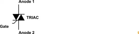

The SSRs you have linked use triacs to control the output. A triac is a semiconductor switch. When the triac is triggered on its gate it turns low resistance between its two anodes. Triacs have the odd characteristic that they will remain on after the gate signal is removed until the current falls below a very low hold-on current. This renders them almost useless in DC circuits but quite useful in AC circuits where the current falls to zero at every zero cross of the AC supply.
Figure 1. Common triac packages.
schematic
Figure 2. Triac symbol.

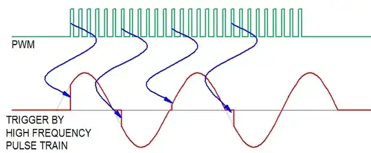

Update
Could you provide a waveform for PWM input and SSRs behavior if possible where we can see why it doesn't work?
Why PWM doesn't work with triacs.
Figure 5. The result of switching a triac with a PWM signal.
At the start of this answer I emphasised the statement, "Triacs have the odd characteristic that they will remain on after the gate signal is removed until the current falls below a very low hold-on current." This is key to the problem. In Figure 5 we can see that the triac output is off until the first PWM pulse is received. It then turns on and stays on until the next zero-cross regardless of the PWM switching. The result with continuous PWM will be that the triac turns on with the next PWM pulse after each zero-cross and stays on. Note the last half-cycle in the AC waveform. The triac is still on even though the PWM has stopped.

  • Added PWM / triac waveform. See Figure 5 onward. – Transistor May 13 '16 at 10:34
  • In your last figure the SSR doesn't have zero crossing right? – user16307 May 19 '16 at 23:01
  • Correct. If the SSR is zero-crossing type it would only turn on if and when the PWM 'on' overlapped with the SSR's zero-cross period. i.e., it would be hit and miss. See my answer to Using AC current to trigger triac where I explain the inner workings of a zero-cross SSR. – Transistor May 19 '16 at 23:09
