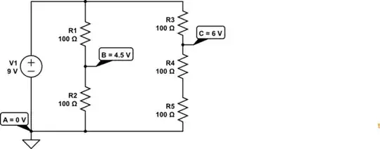

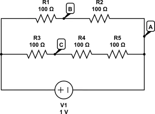

I am a beginner and have been doing some circuit problems from a book. However I am confused about this one:
schematic
Question:
Assume a 9V battery and all reisistors are the same value. What is the voltage drop across
  1. A and B?
  2. A and C?
  3. B and C?
Answer:
  1. is 4.5 V. I understand this one.
  2. is 6V. This is fine as well.
  3. is 1.5 V. I don't get it.
The book simply says to do 6.5 - 4.5 = 1.5 but provides no explanation why.
I made the circuit and 1.5V is correct. (Incidentally it is -1.5V if you move point C one resistor to the right.)
What is the actual path of the electrons in this case?
Do they go from point B, through R1 (+4.5V) then "backwards" through R3 (-3V) to get a reading of 1.5?
Or does the voltmeter allow them to take a shortcut, avoiding R1?
What is really happening?
I have searched for an answer but cannot find a similar circuit anywhere else.
Thank you

  • Notice that $V_{AB} = V_A - V_B = 0 - 4.5 = -4.5 V$. But $V_{BA} = 4.5 V$. Also, $V_{CB} = V_{CA} - V_{BA} = V_C - V_B$. – Dor Jul 31 '16 at 07:11
schematic
Figure 1. Circuit redrawn with positive rail on top and negative rail on bottom.
Voltage is a measure of the "electrical potential difference" between two points. This is analogous to height difference between two points: you place the end of the tape measure at one point (your reference) and measure the distance to the other. Common practice is to use a standard reference such as the ground or sea-level.
The standard schematic layout convention makes this a little easier to understand. We draw the circuits with the highest potential (voltage) at the top and lowest at the bottom. It is also common practice to add a ground point on the circuit whether or not it is connected to real earth. All voltages can then be referenced to this point. Using the reference we can now say that "C is at 6 V with respect to ground".
It should now be clear that if A is 4.5 V above ground and C is 6 V above ground then C is 1.5 V higher than B.
Can anyone tell me what is going on? Where is the electricity traveling to and from in question 3?
Since your multimeter has a very high input resistance there is almost no current flowing from B to C - we are only measuring the difference in voltage. If current were to flow then we would upset the circuit we are trying to measure and the readings would be in error. (In this example with 100 Ω resistors a 1 MΩ multimeter would make hardly any difference.)
Does the voltmeter create a new path for the electricity?
Yes but usually it's negligible. We only have to worry about it if the resistance values are high and the multimeter could affect the circuit under test.
Is there any other way to derive the 1.5V?
The method you have used is the simplest. Figure out the voltage at each point and subtract to get the relative voltages.
So the voltmeter doesn't really affect the circuit at all, it just takes a peek at the voltage at the two points and tells you the difference?

Also for future use, is there a standard place to put the ground point in a circuit?
On a circuit with a single supply the normal convention is that battery negative is the ground reference. Almost all digital logic is designed for a common negative so it makes sense to use this. There are circuits that require a negative supply and circuits that require dual or multiple supplies. so the ground reference can be placed wherever makes sense for that application.
Further reading: my answer to Few questions about basic concepts in electronics may give another slant on the ground question which you may find helpful.

  • Thank you this answer is very helpful. So the voltmeter doesn't really affect the circuit at all, it just takes a peek at the voltage at the two points and tells you the difference? Also for future use, is there a standard place to put the ground point in a circuit? – thatsagoal Jul 31 '16 at 09:09
  • See the update. – Transistor Jul 31 '16 at 10:34
A voltmeter measures the difference between two voltages, so C is at 6 volts with respect to A if the voltmeter is connected from A to C.
Likewise, with the voltmeter connected between A and B, it'll read 4.5 volts and connected between B and C it'll read the difference between B and C; 1.5 volts

  • Thanks for taking the time to answer. What is the actual path of the electrons in this case? Do they go from point B, through R1 (+4.5V) then "backwards" through R3 (-3V) to get a reading of 1.5? Or does the voltmeter allow them to take a shortcut, avoiding R1? What is really happening? – thatsagoal Jul 31 '16 at 08:52
