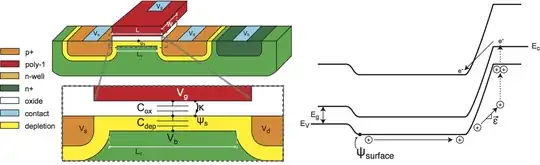

I can guess the those papers are by Duffy, Hasler, Basu, Tor, and Krumenacher; however, I do not believe that a hot-electron injection model due to impact ionization (which is why I assume you are using a pFET) has made it into the public, but I don't keep up with those circles anymore. Chapter 2 of Hasler's Ph.D. thesis from Caltech under Carver Mead will give you the complete modeling for the nFET. Duffy's draft is floating around and he did pFETs but to my knowledge, he did not complete his work. The quantum effects are the same for the tunneling for both nFETs and pFETs; however, the pFET physics for injection is different.
injection bands
Here's a visual description of the process from my work. You can modify Hasler's work by figuring out the probability of impact ionization and then the gate conditions required to attract the electron to the gate. You can use a voltage-controlled current source with an ideal BJT to give you a nice logarithmic control between the gate and the drain because the barrier \$\Phi_{DC}\$ will control what you are looking to model.
I use the EKV model for this, but it is a bit sloppy just due to my implementation. I actually back calculate what is required by the FETs data from EKV 2.6 extraction, and then get the doping and you can go from there.

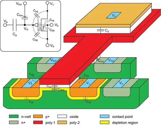

EDIT: Based on the comments, the current through a pFET in EKV without drain dependence would be $$I_{f,r} =I_{thp}\ln^2 \left[1+ e^{\left[{\left(\kappa \left(V_b -V_g+V_{thp}\right)\right)- \left(V_{b}-V_{s,d}\right)}\right]/\left({2 U_{T}}\right)} \right]$$ and this gives you an equation where the surface potential is \$\kappa V_g\$ because \$\kappa\$ is the channel divider. This is what control the surface. When you make the device "float", you end up with this capacitively coupled mess: floating-gate
The surface potential with respect to the new "gate" terminal is $$V_{fg} = {V_{Q}} + \frac{C_{in}}{ C_T}V_g+ \frac{C_{tun}}{ C_T}V_{tun} + \frac{C_{gd}}{C_T}V_{d} + \frac{C_{gs}}{C_T}V_{s} + \frac{C_{ox}}{C_T}V_b$$ Therefore, as the floating node becomes more "negative", the threshold will shift from the standpoint of the gate input. I always reference everything from the surface when I use these devices because you then don't need to worry about different capacitor sizes and behavior.

  • One note: although the floating-gate ideally gives you a perfect voltage offset, the realities of layout are that capacitive dividers exist everywhere. Furthermore, the drain looks to have a larger DIBL due to back coupling from the drain to the floating gate note. Mind if I ask which institution you are attending? I'm just curious if it's one of my colleagues; some of them are devious with trick questions. – b degnan Jun 14 '16 at 12:12
  • I am from TU Dresden. I have one confusion, may u can give me a hint. As per my knowledge, when floating gate is programmed then threshold voltage is increased and less current flows through it. Is it the same case with PMOS floating gate? because the measurements that I have shows higher current for program and low current for unprogram floating gate. – frasheed Jun 14 '16 at 12:49
  • @frasheed I expanded the answer to include the surface references. I realize that you are using UV instead of tunneling, but I never used it due to how much metal we used. Just remove the tunneling junction. I know no one at Dresden, so good luck. There's only a very small group of us who know how to use this technology well. Good luck. – b degnan Jun 14 '16 at 13:39
