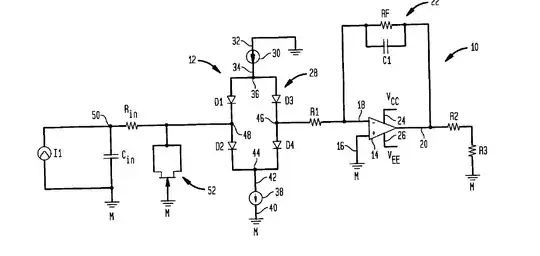

in search i found some thing similar to my need here
the patent claims: in the picture the current sources 30 and 38 are the maximum current at which the TIA saturates, as soon as the TIA saturates, the schottky bridge isolates the TIA from source,
i have less idea whether the patent circuit can work for pulsating current, but when i tried the results did not show any difference

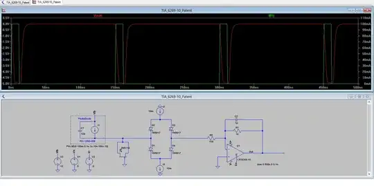

EDIT: with constructive comments i have changed the FET to p-channel which worked like charm, but i am not very clear of
how to select the schottky diode and also the pJFET for much better response
if you see below schematic i have given a trail of pJFET of all available with LTspice, and same with schottky
Result after change in type of FET to PJFET, you can clearly see the input current being more than current sources

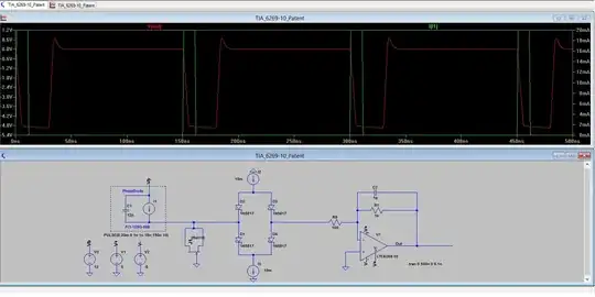

for realizing these current sources i have chosen a 2 terminal programmable current source from LT, which solved the problem to an extent, but few problems still exist
Modified Design:

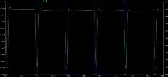

Results with 10uA pulsating input:

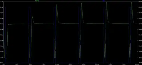

Results with 100mA pulsating input:

even though the excess current is limited i want the waveform not to distort, kindly point out flaws in the design

  • What happens if you reverse your input current? Also, you might need to use "real" current sources (current mirrors) rather than ideal current sources for I2 and I3 to avoid this circuit going crazy. Think about what happens if I1 produces 15 mA. How is KCL satisfied without something else going nuts (like a didoe going into reverse breakdown)? – The Photon Jun 06 '16 at 16:20
  • Now I read the patent (esp. paragraph 0024) and I am pretty sure you need to reverse the polarity of your input source to make the circuit work as expected. – The Photon Jun 06 '16 at 16:29

From the patent you cited,
[0024] The function of the diode-connected transistor 52 is to supply additional current to the current source I1 during the overdrive condition. During the overdrive condition, the current source I1 in the exemplary circuit arrangement shoWn by the FIGURE requires a current of 1000\$\times\$10 uA or 10 mA.
In order for this to happen, you need to either use a p-channel JFET instead of n-channel, or you need to reverse the polarity of your input source (I1), so that it can draw current through the diode-connected FET when the overdrive occurs.
Basically, this circuit only works for one polarity of input current. That's okay, because a lot of typical use cases for TIA's (like amplifying photodetector signals) only involve one polarity of input current.
This is not possible. A limiting circuit inherently introduces distortion into a signal. Imagine you input a large-amplitude sine wave into a limiting circuit. The output would be closer to a square wave. This is a textbook case of distortion, and is the expected and desired result when you use a limiting circuit.
Possibly you should consider an automatic gain control (AGC) amplifier instead of a limiter.

  • Find the design updated and results – kakeh Jun 08 '16 at 10:37
