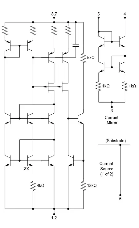

One IC that's worth studying is the TI (nee Burr-Brown) REF200, which has a representative schematic supplied on the datasheet. It has two two-terminal current 100uA +/- 0.5% source/sinks and a precision current mirror (full Wilson current mirror with emitter degeneration resistors). Also see AB165 , which covers a wide range of current sources.
IMPLEMENTATION AND APPLICATIONS OF CURRENT SOURCES AND CURRENT RECEIVERS
