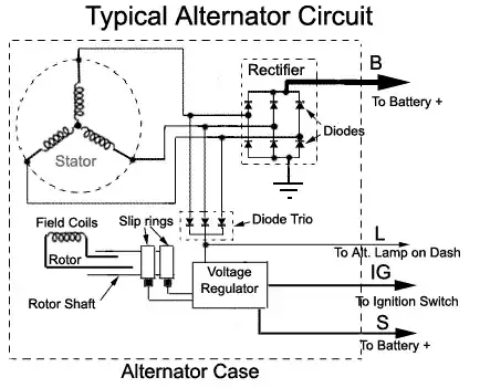

I watched a video where a car battery was accidentally connected backwards and the main 80 amp fuse blew yet no other damage occurred. Makes me wonder what failed that drew so much current?
Nothing 'failed'. With the battery connected in reverse the rectifier in the alternator would have been forward biased, causing a very high current to flow because it is connected directly to the battery. Luckily rectifier diodes can handle very high peak currents, so provided the fuse opened quickly they should have been protected.
Here is a typical alternator circuit. The arrows on the rectifier diodes show the direction of current flow. Normally the diodes steer current from the stator coils into the battery, but block current from going from the battery back into the coils. However if the battery is connected in reverse then its positive terminal is connected to chassis ground, so it can push current straight up through the diodes.
Most solid state devices have components that are polarity sensitive, whether by design or as an inherent part of their makeup. If the device is not specified to handle reverse polarity then you must assume that it can't.
Don't plug a power supply into a device it was not designed for without first verifying that the voltage and polarity are correct. Never connect an electronic device directly to a car battery without a fuse!

  • Ah that diagram really helped me get that aspect. Thank you – ohmmy Jun 04 '16 at 20:56
