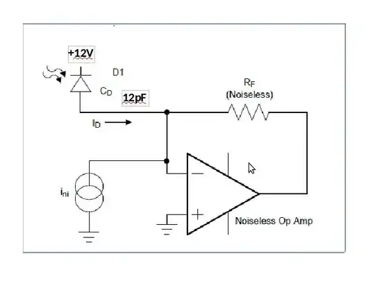

After some useful comments said by Andy here i just wanted to see this, how far i can go with a TIA
Let’s see what amount of noise i will have, with my requirements
Photo Diode is this Opamp is 6269-10
a Noise model of TIA enter image description here
Calculating the Equivalent input noise of an opamp from the standard expression
Reference:surprisingly the application note tries to sense 10nA - 1uA using their TIA but i did not get how they are able to sense 10nA in their example at a BW of 80MHz,anyways we will come back to the calculation
The components being input spot noise, noise voltage term, thermal noise term, and capacitive noise term respectively
1. Current noise term : In = 7pA/rtHz
In @ 200MHz (even if rise time is 2ns(photodiode rise time) it corresponds to BW = 0.35/2ns which is 175Mhz, so let’s go by more +25MHz) = 7pA * sqrt(200M)= 98.9 nA = nearly 100nA
2. Voltage noise term : en = 5nV/rtHz
( i have seen a 1nV/rtHz fully differential opamp i don’t know whether it can be used for the purpose of TIA, experts have to suggest is it desirable to use LTC6409 but datasheet seems like i cannot go for high gains with this )
Voltage noise term = en/Rf
At 200MHz en = 70uV
Term becomes = 70uV / 20K =3.5 nA
if i select a less voltage noise opamp its current noise is high ! (as per seen components like LMH 6629)
3. Thermal Noise term rt(4KT /Rf)
(i want to go for extreme case only -40dC to 70dC )
4*1.3*10^-23*(70+273) = 17.8 * 10^-21 J
17.8*10^-21 / Rf = 89*10^-26 = term which can be put aside for now?! When compared to the actual problem
4. Input capacitance term:
Important factor which has effect of increasing gain even
Input capacitance term = en* 2 * pi * f-3dB * Cin/rt(3)
En = 70uV
Cin= Cd(diode)+Cdif(opamp diff input)+Ccm(common mode inp)
= 12p + 0.1+0.45 =12.55pF
F-3dB = rt(4G/(2*pi*20K*12.55p)=50MHz
Total term = 70uV * 2* 3.14* 50M * 2.55p /(rt(3))=32359*1p=32nA
So the total input noise will be 132nA itself where as i am trying to sense 10nA :/
5. Now calculating high frequency noise gain,
NG = 20log (1+ (Cs/Cf)) = 20log (1+ (12.55p/100f)) = 42dB
NG = 125
So 132nA would become 132nA*20K*125 = 330mV which is horrible!(or did i do any blunder in calculation)
The signal which i can detect or measure would be at least 800mV-1V which is equivalent to input 50uA so this is my lowest limit , when going with a 5V supply i would saturate at 250uA only so my dynamic range is horrible to be ridiculed :(
Where i was aiming for 35dB at least
So if this is the situation i can simply avoid using a TIA and can go for using a resistor of 50ohm which gives me out a 1mV output voltage which i can keep as threshold and give the signal to a high speed comparator and do the digital conversion!
Why should i go for a TIA if i am not able to sense less than 20uA???
If there are any calculations mistakes please correct me in calculating the minimum current that can be sensed
Now suggest me what can be thought, will any of below examples would work?
a. Recieved some harsh but useful comments on unavailability of high speed FETs here , if i want to use the approach of bobs
b. Failed to create a log amplifier, have to give a try once more,give your comments here
c. Going with a configuration like this with a FET at input for reducing input noise? Any way my opamp has a FET input, adding one more FET at input, have to see the effects, will it help ??
d. Leaving the TIA and search for alternatives? if so please suggest

  • You're missing the bandwidth factor in your expression for thermal noise from Rf. 2. You're neglecting the effect of the input node capacitance when converting voltage noises into current noise. 3. In the end, your best solution may be to shop for an op-amp with better characteristics for your application (there are devices available with less than 1 pA/rtHz) 4. If you can't get the gain you want with one stage, you might have to use two. Not being able to get everything you want in one device is a normal part of engineering.
  • – The Photon Jun 01 '16 at 16:30
  • Also, your amp's datasheet specifies 7 fA/rtHz current noise, but you calculated with 7 pA. That's going to make a big difference in your result. – The Photon Jun 01 '16 at 16:31
  • :) 7fA/rtHz .have a look at current density curve and its value at 200MHz, never ever believe those bullet points in first page – kakeh Jun 01 '16 at 17:41
  • Hmm, That's not the usual i_n(f) characteristic...Flat at high frequencies and 1/f at low frequencies is more usual. Suggest you search for a better suited device and save LTC6269-10 for when you don't need 200 MHz bandwidth. – The Photon Jun 01 '16 at 18:12
  • i have seen many opamps, its only few which show what happens to noise density at high frequency,only better i found LTC6409 which will have gain problems i feel, its a unfair conclusion that i am not able to shop for a better opamp, i have seen enough FET input TIAs and the ultimate is this LTC6269-10 – kakeh Jun 02 '16 at 02:49
  • for example see OPA657, they show noise density only up to 1MHz, but not what happens at 100MHz onwards, the same similar curve is present with LTC6269 followed by high frequency noise density response at difference capacitance in pg.13, so to reduce current noise i have to reduce my photo diode capacitance to atleast 1pF using a bootstrap technique,i will try and post the results – kakeh Jun 02 '16 at 03:51
