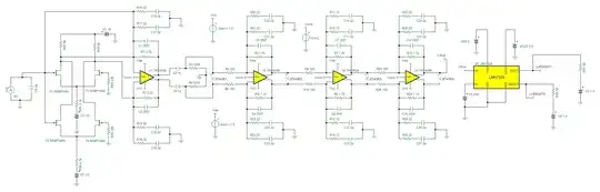

here below i have the schematic and results obtained,and the results were not at all up to the mark as expected in the comments
schematic: enter image description here

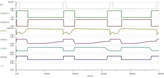

10nA input perfectly output is preserved enter image description here
1uA input enter image description here

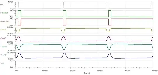

1mA input enter image description here

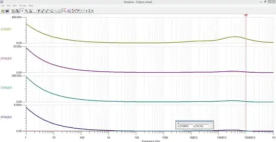

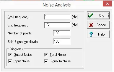

my simulator shows me some noise analysis results which looked impressive, but i have to find out how they are calculated
At the end the pulse width is not all maintained, my current implementaion failed due to saturation of opamp i believe, any how doors open for the comments and criticism

  • Regarding the update (6 years ago), I did a coarse estimation, the noise at stage 4 is ~0.5mV/rtHz at high frequency, and at a bandwidth of 100M, this translates into 5Vrms noise, I don't think you will get anything from the output... – Wjx Sep 17 '22 at 08:03

  • i thought people will raise this, the dynamic range is in respect to photo diode not TIA, 2. you are right, but i am using a current protection(under eval) i wont let a 100mA to pass to TIA even 3. i have a noise suppression using differential FET pair as like one suggested by bob http://electronicdesign.com/analog/whats-all-transimpedance-amplifier-stuff-anyhow-part-1, through which i can reduce noise up to few uV, as soon as i complete circuit fully i would post it, my main concern is dumping my present approach and choosing a new one, by the way the OPA i am using is LHM6629 4stages,

  • @kakeh - Dude, I admire your cojones, but following Bob Pease's advice scaled up to sub-GHz frequencies is not remotely simple. Commercial FETs that work at 1 nsec around an op amp loop? Are you kidding? Furthermore, your op amp current noise over this bandwidth is going to be nearly 50 nA rms which is not what you call compatible with your 10 nA pulse amplitude. Again, unless you provide a schematic, I will remain deeply, deeply skeptical. – WhatRoughBeast May 13 '16 at 04:53
