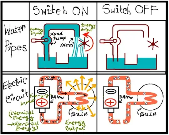

Take analogy with Water flow
Take an analogy with water-flow . ( Current=>Flow of something)
If you stop the hand-pump, water would not flow, and energy transfer in form of water-flow would stop.
But the water would still remain there.
Likewise, Electric-current is the flow of charge.
If we break the circuit, current of the charged-particle, will be stop;
but the charged particles (and they're chemical component of the matters) would still remain there.
They would just stop there overall(net)-movement.
They would also not be able to carry the energy.
When the battery finishes; all the reactants in the battery get converted into product as much as possible (the remaining reactants, if any, no-more could be obtained in equivalent amount) . so it can no-more continue pump electrons.
When battery finishes, The electrons remain within the constituent-material of circuitry.
While battery works and gradually finishes, the energy (that was stored in battery), gets out to environment The energy (=unstability; or ability to do work) that was stored in new-battery, comes out (when the electrical current do some work in the gadget). The energy, gradually lost in the surroundings when the gadget works. Say, for your tablet-computer, the energy lost as the lights coming-out from display, the sound from speakers, the heat from electric-paths, etc.
