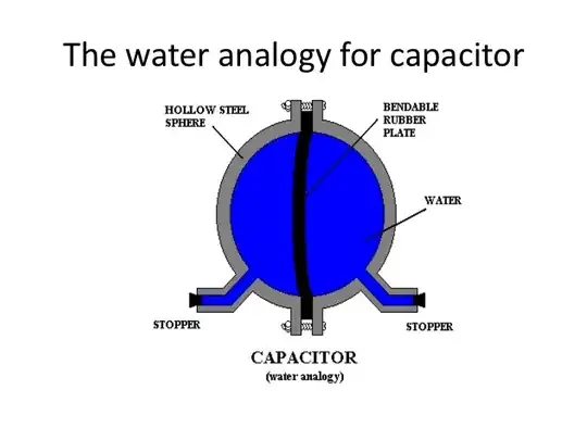

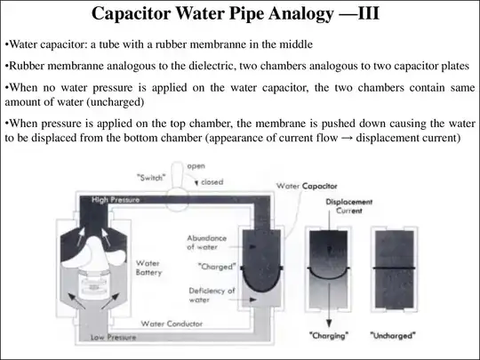

I suggest you start using water analogies for describing the working principles of electric components. In my experience, water analogies are best for understanding electricity. Here's a very good analogy for DC electric circuit with capacitor.
enter image description here Source: https://www.slideshare.net/avikdhupar/robotics-workshop-ppt
enter image description here Souce: https://ppt-online.org/22777
Marino
  • 61
  • Thanks for that (although I'm trying hard to ignore the "membranne" typo). The idea of the membrane "bursting" with too much pressure is irresistable! What I've found though is that the water analogy fails quite quickly when trying to describe inductance - the third concept after resistance and capacitance. Talking about how inductors work using electrons works far better than the whole "water" thing - unless you've got a better description? – John Burger Feb 27 '20 at 12:11
