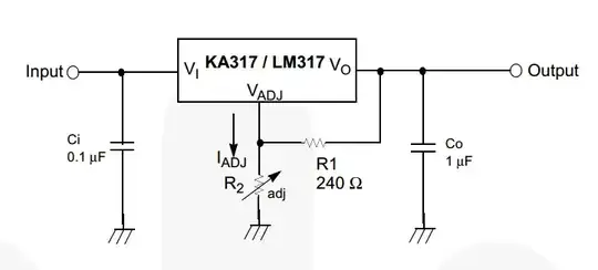

The two capacitors used in the LM317 typical application are described on page five of this datasheet. An identical schematic to the one you provided is given:
lm317 application
Along with a helpful note about why the capacitors are needed:
Note: 3. \$C_i\$ is required when the regulator is located an appreciable distance from power supply filter. \$C_O\$ is not needed for stability; however, it does improve transient response. Since \$I_{ADJ}\$ is controlled to less than 100 μA, the error associated with this term is negligible in most applications.
The best practice, for either capacitor, is to always include them. Specifically for \$C_i\$, place it as close to the input pin on the LM317 as reasonable.
If you have determined that you know what you're doing, you can decide to omit or alter the suggested schematic. In determining that, for \$C_i\$, an appreciable distance in on the order of centimeters, but you should also factor in the level of noise you expect on the input supply and how much the load the LM317 will be changing. For \$C_O\$, you can likely omit it if you have decoupling capacitors at the inputs of any ICs and relatively high current draw devices, anywhere things are going to be changing how much current they're drawing in a short amount of time.

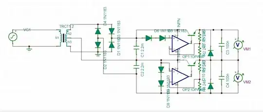

Here is my circuit using my simulator of choice: Texas Instruments 2016 release (it's only release) of the incredibly easy to use and simulate TINA (plus it's smorgasbord of TI parts already in its component select menu and multitude of examples. They don't have the LM337/LM317 in there though so I used Op-Amps with a single pass transistor output stage with two Diodes on their Non-Inverting inputs to represent the Band-Gap Voltage Reference.
enter image description here EDIT: I wrote this while walking and using Voice2Text so I corrected the errors my phone made
LOOK-UP TABLE TO BE USED WHEN RECTIFYING AC VOLTAGE TO 25-VOLTS IN THIS CASE. IF YOUR DESIRED VDC IS 12 THEN DEVIDE THE NUMBERS IN THE FOURTH COLUMN BY 25 THEN MULTIPLY BY THEM 12. DISREGARD THE LAST THREE COULMNS ON RIGHT AS THEY ARE SIMPLY THE RATE OF CHANGE OF THE VAC IF YOU WANT TO DO INDUCTANCE OR CAPACITANCE FIELD EQUATIONS. THIS ASSUMED A MAINS FREQUENCY OF 50Hz RECTIFIED TO 100Hz: enter image description here
