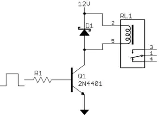

You are right in that you can't just drive a relay straight from a microcontroller. However, that is still simple to do:
The digital output turns on the transistor, which then turns on the relay. Size R1 to make sure the transistor is saturated when on. Let's say it takes 50 mA to energize the relay, and that the transistor can be counted on to have a gain of at least 50. That means you need a minimum of 1 mA base current. If the digital output goes to 5 V when high, and the B-E drop is 700 mV, then there will be 4.3 V across R1. (4.3 V)/(1 mA) = 4.3 kΩ, which is the largest allowed base resistor. 3 kΩ therefore sounds like a nice value that provides some margin over the minimum required base drive, but would not load a normal digital output. (4.3 V)/(3 kΩ) = 1.4 mA, which just about any digital output can source.

  • My issue with this is then I need a power input for the arduino, a power input to power the transistor, then power for the actual relay. Would I use the same power supply for all three? – Burton Kent Feb 05 '16 at 20:17
  • Use the same 12V power supply to power the Arduino, the relay circuit above, and your pump. – Steve G Feb 05 '16 at 20:49

  • @OlinLathrop Why a relay though? How is that better than the other options? – Burton Kent Feb 06 '16 at 20:03
  • @Burt: It is simple to understand, forgiving, and robust. To use a FET, for example, would require more expertise that the OP doesn't seem to have. Relays are harder to screw up. – Olin Lathrop Feb 06 '16 at 20:11
