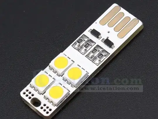

This question is inspired by Connectorless USB on a PCB. I saw a cool USB LED on AliExpress that can be inserted in either direction:
I'd like to build a board with a similar symmetric connectorless USB plug, but I am pretty sure the unused side of the connector will short out against the two tabs that I see on the inside of the metal sleeve of most USB Type-A sockets:
Since the AliExpress board works, I assume that a portion of its circuit handles the case where the +5V lead on the connector touches the sleeve. I bet that responsibility lies with the two diodes I see on the board near the connector.
If these assumptions are correct, would you please draw a partial schematic that shows the relationship between the diodes and the two sides of the connector? If nobody answers, I'll use a continuity tester on one of these USB LED boards to deduce the circuit myself, and then I'll post an answer. But I am a novice with electronics design, and I'd appreciate the expertise of someone who really gets what's happening in this circuit, rather than my own blundering observations with a multimeter.
And an extra bonus question: what is the function of the two tiny angled sections on the AliExpress board's connector that are absent on almost all other male USB plugs?
Do they do anything? Are they racing stripes?

    The image appears to have been altered to delete package markings and traces so a schematic likely can't be sketched. The data pins (inner) are pushed back so that power/gnd is connected first before the data pins (look inside a regular usb connector and you will see this there too). I suspect the extra bit of copper at the end is there to "push" the contacts on the receptacle so that the edge of the data pad is not as liable to be scratched or divoted by a particularly stiff contact or someone trying to stuff it into an incorrect receptacle – crasic Jan 07 '16 at 07:06

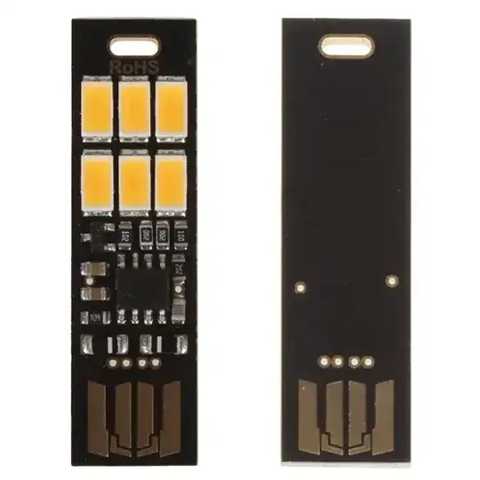

    I'm pretty sure the SOIC8 is a small microcontroller. On the back side you can barely make out a large pad that acts as a capacitive touch sensor that lets you switch the light on/off or PWM-dim it. – sowbug Jan 07 '16 at 15:01
  • @crasic, the item I have in possession doesn't have any more traces visible. As Passerby said, the solder mask is indeed quite thick. – sowbug Jan 07 '16 at 15:02
    @sowbug it's likely not a mcu, but a dedicated touch sensor. There are ones that will allow automatic dimming and such, without needing to be programmed. – Passerby Jan 08 '16 at 03:42
A better picture, black diodes on white board. enter image description here
Big Clive on youtube did a video on these very same boards about 2 years ago, including a schematic starting at 1m50s.
It is a simple diode OR circuit. The diode simply prevents the grounded VUSB pin from shorting out, via reverse protection. General idea:
schematic
Important Design Consideration: The Diodes will induce a Voltage Drop equal to their Forward Voltage. Typical Silicon Diodes have a 0.7V Vf, while a Schottky Diode or Germanium Diode will have a lower Vf of 0.2V~0.4V. Plan according to your needs.
As for the extra copper on the data lines, that looks it's just for style. Like flames on a hot rod. It makes it go faster. The same style is used on most of the black boards.
