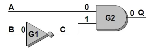

Based on the answer below I agree that the assignments will be happening in a single time step. But consider the circuit below: enter image description here
In the document I mentioned it is said that the assignments at C and Q will take place in two time steps. But suppose I code the circuit as follows:
always @ (A or B)
begin
C=~B;
Q=A&C;
end
Shouldn't the assignments at C and Q take place in a single time step?

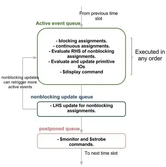

In Verilog, there is a well defined event queue as shown below. For each and every timestamp, all the regions are evaluated. If there are any events to be executed in current timestamp, then they are triggered. Once all the events of current timestamp are triggered, then only simulation time moves forward.
Verilog Event Regions
Coming to your example, if a changes, always block is triggered and ALL the statements are in always block are executed. x, y,z are assigned the values immediately. This all happens in ACTIVE REGION of same timestamp. Even one of he variable in sensitivity list changes, all the statements are in the block are executed.
Refer Blocking-Nonblocking difference, Cummings_Verilog_Nonblocking paper, and Event Regions paper for further information.

Referring to PDF again:
The two-phase structure of the event-driven simulation algorithm imposes a time scale on the simulation...It is usually assumed that an arbitrary number of simulated time units can occur between successive input vectors.
For the circuit, if both A and B changes, then according to event driven simulation model, G2 is evaluated since A has changed, at lets say at 0ns. Along with G2, G1 is also evaluated due to B at 0ns. Thereafter, G2 is evaluated once again due to C at 1ns, producing output at 2ns.
If either A or B changes, then G2 is evaluated once, since either of A or C shall change. If only B has changed, then it must take 2ns delay while changing A shall result in 1ns delay.
