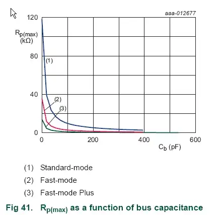

I2C (as opposed to "two wire bus" or whatever others want to call similar buses), should follow the NXP (née Philips) standard, UM10204 I2C-bus specification and user manual. That should be your primary reference document, not the various interpretations and subsets that exist elsewhere.
The maximum number of devices will be influenced by the drive capability of the weakest output (which in turn determines the minimum pullup resistor), the wiring and input capacitance, and the operating mode/frequency. See section 7.2 Operating above the maximum allowable bus capacitance if the maximum capacitance must be exceeded:

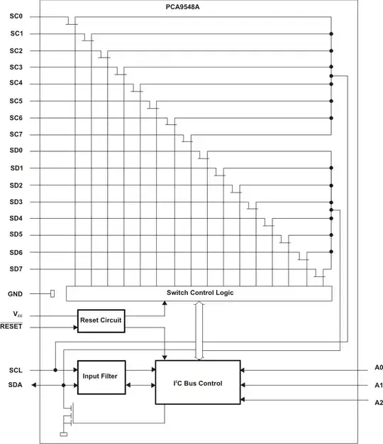

An i2c bus is limited mainly by the capacitance of the bus (and thus speed), and accessible device addresses. And physical board space.
But there is no real upper limit, when you factor in bus buffers, extenders, repeaters, hubs, multiplexers, switches (or any other name for a device that can switch between multiple busses). These add some i2c overhead, as may can be accessible via the same i2c bus. The PCA9548A for example, is an 8 bit bus switch.
This single chip can theoretically quadruple the number of i2c slaves (127 * 8) otherwise available. And the PCA9548A can be configured for up to 8 addresses on a single bus, so 8 * 8 * 127 devices. (math may be off). And that's just with this device and not more.
Frankly, there is no theoretical limit if you adjust for capacitance.

With added multiplexer chips (like TCA9544A) or buffers (like PCA9515B) you can overcome all limits - both bus capacitance and addressing.
You can place 3 devices with identical addresses behind a multiplexer and select only one of them, communicate with it and later select another. Of course software gets more complex.
If you have long wiring you can place a buffer in the middle and overcome the capacitance limit.
