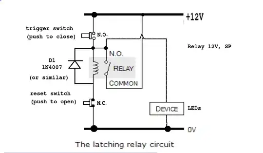

If I'm reading this question correctly all you need is a very simple relay latch such as
Top push button (push to make type) sets the relay ON by connecting the coil to the 12V rail. Once the relay contacts close this supply will be maintained through the relay contats.
The bottom switch (push to break) will break the coil circuit and the relay switches OFF. D1 is there to reduce the back emf spike (on turn off) and prevent arcing across the switch.
