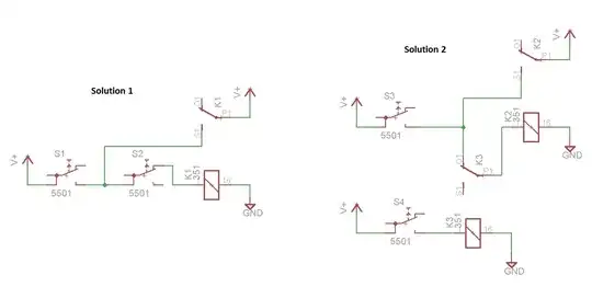

Both of the two solutions below use one button for turning on, and a second button for turning off. The difference between the two, is thr first uses a NC button for turning off, which may not be available. The second solution uses NO buttons for both actions.
In both cases, when the first button is pressed, the relay activates, and the contact is closed holding the relay in the closed position until the circuit is interrupted.
Doing both the on and off actions with one button is considerably more complicated.

The off limit switch is wired as a normally closed, the on as a normally open.

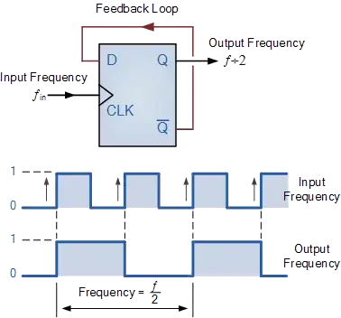

Use a D type flip flop with Q bar wired to the D input. Each time the clock pin is activated by a button press it flips the output Q pin. This, via a transistor can drive a relay. You also need to have some contact denounce circuitry to prevent relay chatter. This is a one switch solution.
(source: electronics-tutorials.ws)
Above is the basic circuit and input frequency (CLK) is your debounced switch opening and closing. So, you press the switch once to bring the logic level to 1 and the output on Q latches and stays latched even when you deactivate the input switch on CLK. Next time you press your input switch the output toggles state.

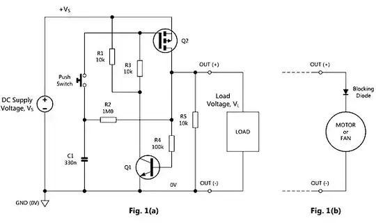

You can even get away from a relay and use a MOSFET in this type of circuit: -
