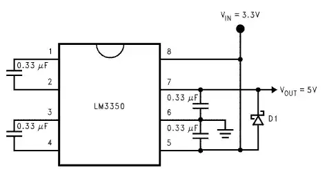

Use a boost converter: -

As @Andy aka says, you will need a boost converter to get 5Volts from the 3.3V that you have.
