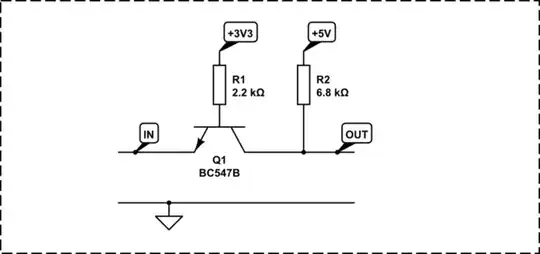

Maybe not lowest component count, but chances are that you have all parts readily available. Any general purpose low power transistor will do and resistor values aren't too critical either.
Possible disadvantage is that it acts like an open collector with R2 being the pull up resistor. This means the rising edge is determined by R2. The 3V3 output driver must be able to sink the current through both R1 and R2, in this case (5V/6k8)+((3.3V-0.6V)/2k2) = 2mA.
schematic
Not sure where I once found the circuit.
Similar architecture can be used with a MOSFET, but you'll have a challenge finding one with sufficiently low threshold voltage.

  • Cool circuit! I've never encountered that one before, and the way the transistor is connected is pretty counter-intuitive but it works. Perfect for microcontroller output pins since they can easily sink that current, and it avoids the second transistor (or having to invert the output bit in software) that's involved in the more obvious simple level converters. – Rennex Sep 04 '14 at 01:56
    Maybe you found it there? ;-) http://electronics.stackexchange.com/questions/82104/single-transistor-level-up-shifter Beware that there are limitations concerning input and output impedance. That should be fine for logic ICs though. – Nicolas D Nov 17 '14 at 17:02
  • Also, it's not energy efficient when the input is low. – Nicolas D Nov 17 '14 at 17:08

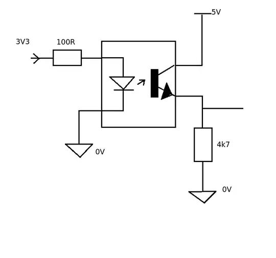

For electrical isolation as well as change in voltage you could use an opto coupler. eg. 4n25. They also come in dual and quad packages as well. A high on the input produces a high on the output.
JIm Dearden
  • 19,036
  • 30
  • 40
  • +1 for the exquisite quality of the hand drawing on this one! –  Sep 03 '14 at 17:06
  • A 4N25 cannot do 800kHz. It has 2us Turn-On time and 800kHz is 1,25us per bit. I tried it before reading the datasheet..... – Hasse Jun 26 '23 at 12:51
