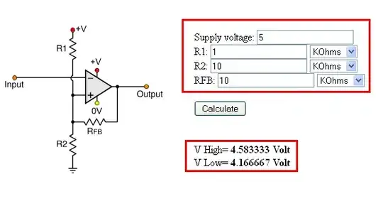

I'm trying to build a Schmitt trigger like the one described here: http://pcbheaven.com/drcalculus/index.php?calc=st_nonsym_sp
However, it isn't working as expected, and I'm thinking it may be due to a number of reasons, only a few of which I have a suspicion of. It would be a great help if someone could advise me on how to properly build a Schmitt Trigger because I'm quite new to this and don't have much experience.

  2. The resistors I used have relatively small values. In the PCBHeaven link I posted above, R1 = 1kOhm, R2=10kOhms, and the feedback resistor was 10kOhms as well. I don't know why this matters, but might it have something to do with saturation of the op-amp? I really don't know.

Just plug those resistor values into the calculator you linked in your question and look what happens: -
The thresholds are switching between about 4.2 volts and 4.6 volts - that's the first thing - your input needs to be able to cross those boundaries for your circuit to switch.

Try lowering thresholds to around 2V and 2.5V and see what happens when the input rises above 2.6V - I'd expect the output to swing down to 0V. When the input drops below 1.9V, I'd expect to see the output swing above 3V.

All that's happening with a Schmitt trigger is that you're arranging the output to bend the threshold voltage (the + input) up and down slightly as the output changes - it's the feedback resistor which does the bending. The feedback resistor is commonly quite a lot larger than the potential divider resistors, because you're usually only trying to have a small influence on the divider's centre-point voltage.
Something like 10k for each divider resistor and 100k for the feedback should give you some kind of easy-to-interpret results. Very roughly-speaking, this would give you the following behaviour:
  • Without the feedback resistor, you'd have 2.5V at the centre of your divider, so the output would switch as the -ve input moved across 2.5V.
  • With the feedback resistor fitted and the output high (-ve input low), you'd have about 2.6V threshold voltage - that's because you've got 100K and 10K in parallel at the top of the divider, so it looks like roughly 9K over 10K.
  • With the feedback resistor fitted and the output low (-ve input high), you'd have about 2.4V threshold voltage (because the divider looks like 10K over 9K).
