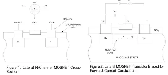

Looking carefully at this diagram of one type of MOSFET:
(found in this application note)
We can see the device is virtually symmetrical. What makes the gate reference itself to the source and not the drain?
Also, why would the gate oxide break down at 20V Vgs and not 20V Vgd?

Because the Figure 1 you posted refers to a 4-terminal device, not a 3-terminal one. If you look at the schematic symbol in Figure 1, you'll note that the body terminal is a separate terminal not connected to the source terminal. MOSFETs for sale are almost always 3-terminal devices where source and body are connected together.
If memory serves me right (not 100% sure -- seems to be corroborated by this handout), in a 4-terminal device there is no difference between source and drain, and it is the gate-body voltage that determines the on-state of the channel -- with the caveat that the body is supposed to be the most negative voltage in the circuit for an N-channel device, or most positive voltage in the circuit for a P-channel device.
(edit: found a reference for MOSFET device physics. The source-drain behavior is still symmetric, but depends on both gate-source and gate-drain voltages. In N-channel, if both are negative, the channel is nonconducting. If one is greater than the threshold voltage, then you get saturation behavior (constant-current). If both are greater than the threshold voltage, you get triode behavior (constant-resistance). The body/bulk/substrate still needs to be the most negative voltage in the circuit, so to get the reversed behavior in a circuit, body + drain would need to be tied together.
In a P-channel device, this polarity is reversed.)

  • Even in 4 terminal the gate source voltage determines state of the channel. So what you have wrote about gate-body is not true. The source - body voltage will modulate threshold voltage of the device. For example for NMOS if Vs is above Vb then one will need bigger Vgs to turn on device (the body effect). – mazurnification Jul 04 '11 at 11:46
  • @mazurnification: where's your reference for this? and why is it gate-source rather than gate-drain or gate-body? I tried to find reference material either way and could not. – Jason S Jul 04 '11 at 12:16
    Just found this reference: http://www.doe.carleton.ca/~tjs/21-mosfetop.pdf which states channel fields based on Vgb, not Vgs (until Vsb = 0 at which point Vgs = Vgb). So I'm not going to change my answer until I see evidence that there's something special about the source terminal. I wouldn't be surprised if the body effect of modulating threshold voltage is only true if the source-body connection is a low-impedance fixed voltage, and that it is equivalent to the equations governing Vgb. – Jason S Jul 04 '11 at 12:37
  • OK, found something that refers to gate-source and gate-drain voltages. – Jason S Jul 04 '11 at 12:43
  • The key is Vgb. The whole point of a MOSFET is for the electric field created between the gate and substrate to imbalance the distribution of charge carriers, changing the impedance of the channel between source and drain. However, since source and substrate are generally connected together (see schematic symbol), Vgs is the same as Vgb. If you don't want the channel to be the same as the substrate, you have to create a well structure, which looks like a reverse-biased diode from channel to substrate. Remember that you can create structures in ICs that are unfeasible in discrete parts. – Mike DeSimone Jul 04 '11 at 13:01
  • @Mike DeSimone - well I kind of disagree with you. It is true that it is all about charge (or carriers) forming channel - but you have pn junction (aka diode) at source/drain to body that you have "overcome" for current to flow. That why vgs is the key. – mazurnification Jul 04 '11 at 13:58
  • @ Jason S - regarding (doe.carleton.ca/~tjs/21-mosfetop.pdf) the MOSFET are described from slide 9 onwards. (MOS is just metal oxide semiconductor stack - and introduction to MOSFET) – mazurnification Jul 04 '11 at 14:27

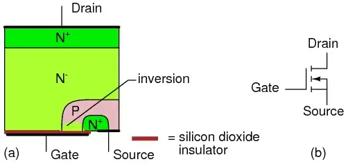

The symmetrical cross-section as it's usually drawn doesn't quite agree with the actual structure, which is highly asymmetrical. Actually it looks more like this:
with a much larger area for the drain than for the source. It's possible to specify \$I_D\$ vs \$V_{GD}\$, but you'll get a totally different relationship, which is rather irrelevant in common source applications, which are the most used.

  • Are you sure this is not just a vertical MOS? Is a lateral MOS different? – Thomas O Jul 04 '11 at 07:15
  • @Thomas - a V-MOSFET looks different: http://www.allaboutcircuits.com/vol_3/chpt_2/10.html. Anyway, they are very much asymmetical, so even if the picture looks different, the explanation still stands. – stevenvh Jul 04 '11 at 07:47
  • This structure is frequently used for discrete MOSFETs. The symmetric structure is usually used for MOSFETs on integrated circuits, since they can't all share a drain. – Mike DeSimone Jul 04 '11 at 12:55

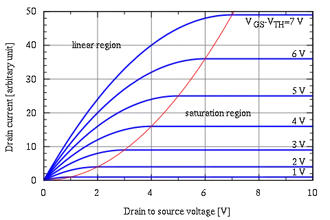

A MOSFET requires two things for current to flow: charge carriers in the channel, and a voltage gradient between the source and drain. So, we have a three dimensional behavior space to look at. The drain-source characteristic looks something like this: enter image description here
Let's assume we have an nmos transistor, and the bulk and source are at 0V. Let's also set the drain voltage high, say 5V. If we sweep the gate voltage, we'd get something that looks like this:
