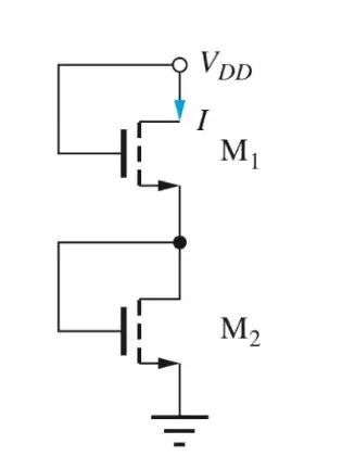

I notice that in solution manuals to problems like these, when the gate is shorted to the drain on an NMOS, Vds = Vgs. So Vds >= Vds - Vtn, making the MOSFET always in saturation.
I do not understand why this is, and have not been able to find a diagram that I could make sense of. How can we explain this more visually?

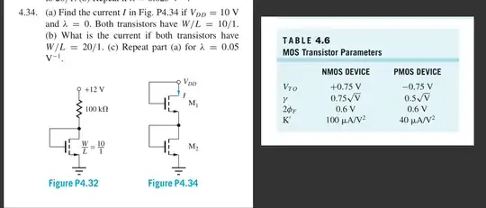

Here is the problem this schematic came from. Microelectronic circuit design, 5th edition.

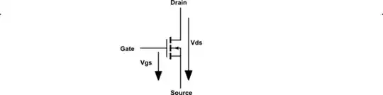

Vds is defined as the potential difference between drain and source, Vgs as the potential difference between gate and source.
schematic
By shorting gate and drain, they share the same potential. Therefore, Vgs = Vds. That much should be pretty obvios.

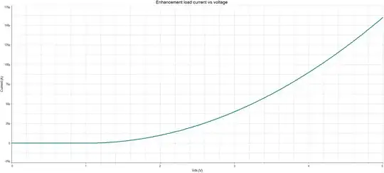

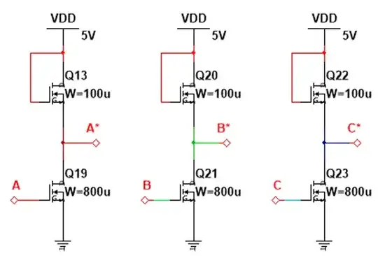

In this configuration, the nmos is called an enhancement load, this makes the nmos act like a diode but the curve is follows a square expression instead of exponential, thus making it a non-ohmic resistor, as follows: A plot showing the current over voltage curve of an enhancement load One circuit where this is useful is one in which an enhancement load is placed on top and an nmos is on the bottom, the output is taken from between them, as follows: A photo of an enhancement load inverter, as described in this post
When the bottom nmos is turned off, the output will be Vdd - Vth. Turning the bottom nmos on will form a voltage divider, getting the output close to zero. This makes this circuit an inverter, although it is not a particularly good one, it is better than having a resistor as that takes a large amount of space on a chip. A better inverter uses a depletion nmos or CMOS, but that is not relevant here.
The circuit you provided with two depletion loads in series acts just like a voltage divider made out of two equal diodes, so the output voltage is half Vdd. This holds true if each enhancement load has more than its threshold across it, and makes current calculation easier as you only need to consider a single nmos with half the supply voltage.
