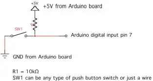

I am reading a book on Arduino & I just do not understand the concept of push-up resistor, following is a quote from the book:
the circuit
Why do we need the resistor R1? R1 guarantees that the Arduino’s digital input pin 7 is connected to a constant voltage of +5V whenever the push button is not pressed. If the push button is pressed, the signal on pin 7 drops to ground (GND), at the same time the Arduino’s +5V power is connected to GND, we avoid a shorted circuit by limiting the current that can flow from +5V to GND with a resistor (1 - 10 KΩ). Also, if there was no connection from pin 7 to +5V at all, the input pin would be “floating” whenever the pushbutton is not pressed. This means that it is connected neither to GND nor to +5V, picking up electrostatic noise leading to a false triggering of the input.
Another book called it Arduino's pull-up resistance because it pulls current towards 5V, which confuses me even more - how can a resistor increase voltage, shouldn't the voltage drop?

  1. What is floating pin?
  2. How does R1 avoid a shorted circuit? Why does it count as short cicuit & not closed circuit. After all GND is a sink.
  3. Is a short circuit serious problem at mere 5V

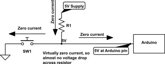

The pull-up resistor isn't increasing the voltage. It's simply connecting the 5V supply that already exists to the digital input pin of the Arduino. Digital input pins are designed to have very high internal resistance, so extremely little current will flow into the pin. If very little current is flowing through a resistor, the voltage on either side of the resistor will be about the same. So R1 will have approximately 5V on both sides of it. That means, most importantly, the voltage at the input pin will be 5V when the switch isn't being pressed.

Whenever the Arduino measures the state of the digital input pin, it can only choose one of two options: high or low. Some external device must be connected to that pin (in your case, a switch) to apply either a high voltage or a low voltage.
But what if there's nothing connected to the pin? You might be tempted to say it should read as a low voltage. Unfortunately, that's not correct. We call this condition "floating". The pin is not being actively driven high or low by an external device, so it's just floating in an unknown state. This is dangerous because the Arduino still must choose high or low when it measures the pin. It can't choose "neither" as an option. Which one will it choose? Who knows. In fact, the physical metal pin itself will act as a tiny antenna and may be affected by any nearby electrostatic field. Simply moving your hand in the vicinity of the chip may cause it to change states sporadically. Moral of the story: NEVER leave a digital input floating.
The sole job of the pull-up resistor is to prevent the pin from floating when the switch isn't being pressed.
Once the switch is actually pressed, the 5V supply has a path to ground through the pull-up resistor and the closed switch. But the resistor will limit the current to a reasonable amount, which avoids a short to ground. Using Ohm's Law, the voltage at the bottom of the resistor will now be very close to 0V. Since that's where the digital input pin is connected, the Arduino will read a low voltage. Now the firmware programmed into the Arduino can safely read the status of the digital input pin and determine when the button is being pressed.
