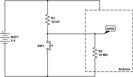

A GPIO pin, when in INPUT mode, can be thought of as a very very large resistor connected to ground. The GPIO pin is interested in the voltage that is across this resistor. Take the following circuit for example:
schematic
A logic HIGH is seen by the Arduino when the voltage at the node labelled GPIO is at, or near, \$V_{CC}\$ (in this case 5V). A LOW is seen when the voltage at GPIO is at or near \$0V\$.
With the switch SW1 open, there are just the two resistors in play - the pull-up, and the internal GPIO port's resistor. So, using simple maths, we can calculate the voltage that would be at GPIO.
First we calculate the ratio of the two resistors, using \$\frac{R2}{R1 + R2}\$, and then multiply it by the voltage, which is \$5V\$. So we have the sum:
$$ \frac{10,000,000}{10,000 + 10,000,000}×5 $$
We can of course simplify that by doing the addition, then cancelling out trailing zeros above and below the line:
$$ \frac{10,000,000}{10,010,000}×5 $$ $$ \frac{1,000}{1,001}×5 $$
And so the answer comes out as \$4.995V\$ - pretty much the full \$5V\$. So the Arduino see that as being HIGH, since it is above its "input logic high threshold", also known as \$V_{IH}\$ in datasheets.
So now what happens when we press the button? Well, basically we create a short circuit across the internal GPIO resistor. So now we can completely ignore that resistor, since we have essentially put a wire across it to short circuit it.
So now our sum gets changed slightly, since \$R2\$ is now \$0\Omega\$ (the resistance of the wire shorting out \$R2\$).
$$ \frac{0}{0 + 10,000}×5 = 0V $$
And of course, \$0V\$ is below the "input logic low threshold", or \$V_{IL}\$.
Another way of looking at it is that the GPIO, when the button is pressed, is directly connected to ground. No amount of tweaking of the resistor \$R1\$ will ever change the fact that the voltage at ground is \$0V\$. The only way you can change that is by short circuiting \$R1\$ so that becomes \$0\Omega\$ as well, and then you have basically short circuited your battery, and all your wires have now melted.

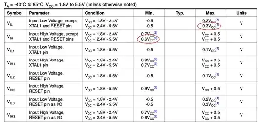

For reference, here is part of Table 28.2 from the ATMega328P data sheet detailing the input voltage thresholds:
We can see there the \$V_{IL}\$ and \$V_{IH}\$ voltages for the \$2.4V - 5.5V\$ \$V_{CC}\$ range listed as \$0.3V_{CC}\$ and \$0.6V_{CC}\$ respectively. Now, this doesn't refer to \$0.3V\$ and \$0.6V\$, but to \$0.3×V_{CC}\$ and \$0.6×V_{CC}\$.
If \$V_{CC}\$ is \$5V\$, then \$V_{IL}\$ is \$0.3 × 5 = 1.5V\$, and \$V_{IH}\$ is \$0.6 × 5 = 3V\$.
So any voltage seen on the GPIO pin that is below \$1.5V\$ is registered as a logic LOW, and any voltage see that is above \$3V\$ is registered as a logic HIGH.

  • Thank you for your detailed answer. It really helped my out. It was really strange that I looked over the fact that there basically was a short circuit taking place (in the GPIO part of the circuit) in the close pull-up case. It was never mentioned, in the tutorials I saw. Maybe they thought that everyone reading/watching the tutorials, would notice it automatically. That it would be obvious, I mean. – A_Person Nov 02 '14 at 08:26

There's a massive error in your thinking about this. When the button isn't pushed, the pin is connected to 5V through a 10k resistor, and to ground via the very large resistance of the chip's input circuitry. Since voltage drop is proportional to resistance, the chip is dropping ~5V, the 10k resistor is dropping ~0, and the voltage at the pin is very close to 5V.
When the button is pushed, the pin is connected to 5V through a 10k resistor, and to ground via the switch (which is ~0 ohms) in parallel with the chip (which doesn't make any difference). Now the 10k resistor is dropping ~5V, the switch is dropping ~0, and the voltage at the pin is very close to 0.
Pull-downs are the same, only in reverse. The pin is connected to ground through some resistance, and normally reads low, but if it's connected to 5V through a much lower-resistance path the voltage on the pin will be close to 5V and it will read high.
The thresholds are fixed. You can find them out in the datasheet for your chip, but a rough guide for CMOS is that an input over 70% of Vcc is high, an input under 30% of Vcc is low, and anything in between is unreliable. Some chips might have a smaller "unreliable" zone, but if you can design to 30% and 70% you shouldn't have a problem.

  • Thank you for answering my question. If I would write down calculations of what you wrote would it be like the following in the pull-up example? R1 = 10 k Ohm; R2 = 1 M Ohm; R3 = around 0 Ohm --
    Calculating R total: R1 + (R2 * R3 / R2 + R3) = R total; 10 k + ~ 0 = ~10 k.
    Proportion of voltage across R1: (R1 / R1 + R2,3) * V ; (10 k / 10k + ~0) * 5; ~1 * 5 = ~5; Or don't these calculations apply here?
    – A_Person Nov 02 '14 at 08:54
  • To clarify R1 would be the pull up and R2 the internal resistor of the GPIO and R3 the path from button to ground. So there will be, - to add to what I said in previous comment -, Vcc - Voltage drop R1 = Voltage at the GPIO pin; 5 - ~5 = ~0 voltage at the GPIO pin. – A_Person Nov 02 '14 at 09:04
