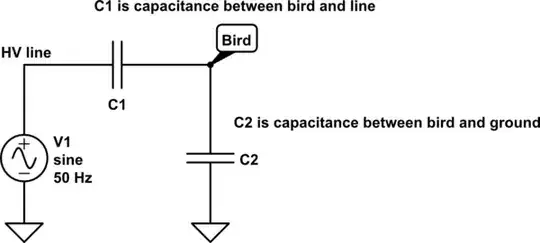

I mostly agree with Andy Aka explanation. I'll give a more detailed theory though (of course I might be overlooking something).
A body doesn't have a capacitance by itself, as it always needs the "second plate" of the capacitor. Humans relative to ground will have a given capacitance when standing (insulated) over then ground, and a different capacitance when flying (if able to) because then ground is farther.
A simple model of the bird could be the one in the next diagram:
schematic
As the bird approaches the line C1 will increase and C2 will decrease. This is a capacitor divider and the potential of the bird will approach the High Voltage (HV) line one.
Let's assume, just to give some quick numbers, that C1 is 100 times C2 just before the bird's feets touch the line, the difference of potential between the bird and the HV line will then only be 1% of HV. Finally the bird's feets touches the line: C1 is "shorted" and the only capacitance to fill would be C2 (capacitance between bird and ground, which is very small as ground is far). Because body potential is already at 99% of HV, and it's capacitance to ground is very small, the current through the bird would be really small.

  • Great explanation, and it clarifies the point Andy Aka was making in his answer. +1 – etherice Mar 08 '15 at 22:02
    It might be worth calculating estimates for those capacities, because I doubt C1 would be able to reach levels high enough for this to be significant (the cable doesn't have a flat surface which reduces the effective area, it's very small which reduces the overlap area with the body etc.). It is still a valid effect that I haven't covered in my answer, definitely worth a +1 (+1). – Mister Mystère Mar 09 '15 at 12:27
  • @MisterMystère C1 is certainly small, but it only needs to be big relative to C2. In the other hand, the cable is not that small (typically it has at least 4 cm diameter) and it is very long. The complete picture would be a long cylinder for the wire, a sphere for the bird and an infinite plane for the ground. If anyone has time to work at this, it would be a nice contribution. I've found something with two spheres: http://www.iue.tuwien.ac.at/phd/wasshuber/node77.html but it is not quite the same! Thanks for the +1! – Roger C. 7 mins ago – Roger C. Mar 09 '15 at 16:50
  • I don't have the time to look into it but a plane is the limit of a sphere when the radius tends towards infinity, so both can actually be solved this way. – Mister Mystère Mar 09 '15 at 17:59
    All bodies have capacitance by themselves; their second plates lie on some distant stars ;) – Victor Popescu Mar 12 '15 at 10:23

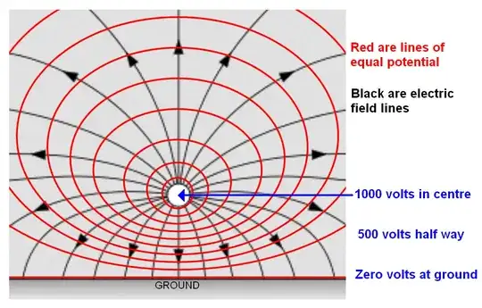

15
NOTE: My understanding of what happens when a bird flies from an earth object to a powerline (please correct me if I'm wrong) is that - upon contacting the wire - its electric potential changes from earth-potential to the powerline's potential
Here lies the crux of the matter. As the bird leaves the ground heading in the direction of the wire, it acquires a gradual change in potential. This is not an instantaneous change because if it were, the bird would experience a current jolt at that instant it landed.
So, no, it doesn't happen instantaneously and, bigger wire voltages = larger distance therefore a longer time period to reach said wire and, without going into the math, the small imperceptible current that the bird experiences will be the same.
Below is a picture of the way the voltage level changes with distance between ground and a "hot" wire: -
This is fairly classical electric field analysis. Emanating from the centre (assumed to be a point of high voltage) are black electric field lines. These exit in all directions from the wire and hit "ground" at right angles. If you chose any particular one of these E-field lines and "traveled" along it from the ground level by (say) 10% of its length, you would attain a voltage that is 10% of the hot wire.
If you did this thought experiment for all E-field lines at different percentages of the length you'd be able to plot all the lines of equipotential and that is what the red lines are.
As you should be able to see the potential that a small object can attain rising from ground to the "hot" wire is remarkably linear.

  • The wording I used in the question is "nearly instantaneous" to be concise. More importantly, the time it takes for the equalization to occur was not the question, but rather if the equalization could result in a fatal shock if the potential difference were large enough. – etherice Mar 08 '15 at 17:10
  • @etherice The point Andy is getting at is the situation you propose cannot happen. – Matt Young Mar 08 '15 at 17:16
  • I think he's arguing that it would not be instantaneous. – pjc50 Mar 08 '15 at 17:41
  • +1 (your answer is much clearer after reading the explanation provided by Roger C) – etherice Mar 08 '15 at 22:56
  • Nice illustration. Only thing that I would object is that in a power transmission line there is 3 phases (120º apart, added voltage is 0) and not a single one. Because you have a superposition of the three electric fields one should not expect a linear potential increase from ground to one of the hot wires. The big potential increase step would happen when the bird really starts to approach one of the hot wires as its field would then become dominant. – Roger C. Mar 11 '15 at 20:48
  • @Roger C - I suggest you go and look at how the individual phases are handles when a pylon is involved. Invariably, for a single circuit 3 phase supply two phases are on one side and one on the other and this still makes a very strong electric field to the ground from the two phases at 120deg apart and still quite linear BUT you are focussing on minutiae at the expence of the bigger more relevant picture. I'll also add that the more common double circuit 3 phase pylon has the same phase in both lower positions at either side of the pylon - http://en.wikipedia.org/wiki/Overhead_power_line – Andy aka Mar 11 '15 at 21:40
  • I see the important point in your post: the fact that the presence of an small object (the bird) won't perturbate significantly the shape and intensity of the electric field originated by the lines alone. This is a very reasonable assumption. And a useful one, because there are indeed studies about the electric fields under HV lines, so that after integration one could get the potential adquired by an imaginary bird at different heights. In the other hand, I'm not so convinced about the linearity, but I agree with you that this is secondary. – Roger C. Mar 12 '15 at 00:07
